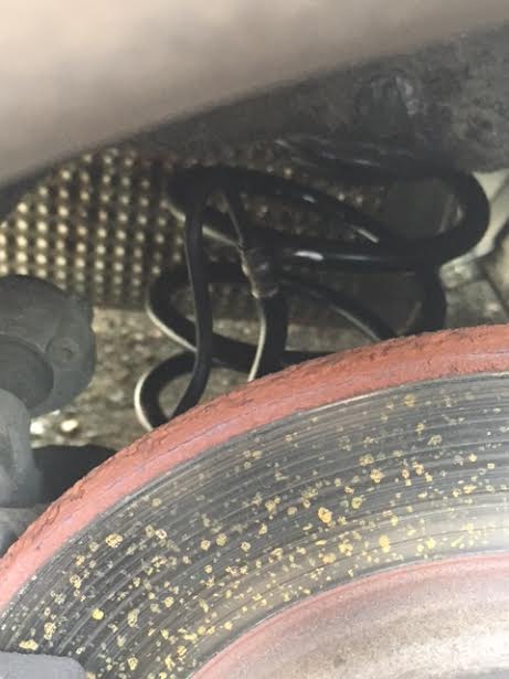

Hi everyone, just wondering if anyone could help me, my rear driver side brake hose split the other day and I'm struggling to find the part I need to get a repair.
You have the pipe coming out of the calliper then a metal piece that looks like it's crimped? Then a rubber pipe (this is the piece that's split) then another metal crimped piece then more pipe.
My question is can I replace just the piece that's split ( the bit between the two metal crimped pieces ) or do I need the full thing?
Cheers

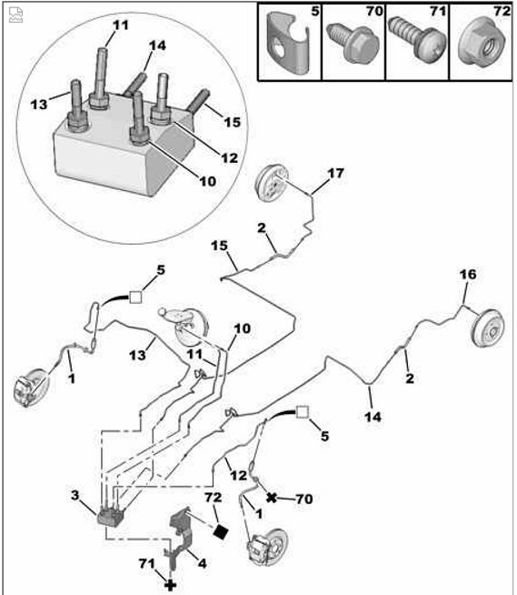

This is a pic from a 5 door 207 1.4HDi , with ABS , without ESP with rear drums as an example.
As you can see its item 17 (assuming RHD car?) or item 2 you'll need. No part numbers simply as these may change if this vehicle spec is not correct, the pic is simply so you can see what I mean about a 'single piece' as such.

Hiya mate thanks for the reply, it's a 207 gt HDi 1.6 2007 ref I'm struggling to find anywhere that stocks the part apart from Peugeot who im assuming will have my pants down.
When I search online for 'Peugeot 207 rear brake pipe' all that comes up is a single hose which I'm assuming is the wrong part then?

Is it (2) or (17) that you need then ?
The part numbers for these for rear discs are as follows (I'd be tempted to call the dealer to just see to be honest, they are not always expensive on brake parts, honest) its worth a quick phone call...
(2) is 4806G2
(17) is 48869 (until build 12410)
(17) is 488GR (since build 12411 to 12746)
(17) is ? (no part number since build 12747)

its the piece under that metal crimp mate, so youve got the pipe that comes out of the calliper that bends up and over then the metal crim, the next piece of pipe (the broken piece) another metal crimp then more pipe

Post up the last 8 digits of the VIN and I can check the correct part no. When I looked the other day one example was only about £20 from Peugeot.

Here you go:
Reference Description Quantity Price - VAT Price + VAT Total + VAT Selection
0000488870 BRAKE HOSE 17.06 GBP 20.47 GBP 20.47 GBP
Can't see anything on e-bay, so think I would just go for the dealer.
