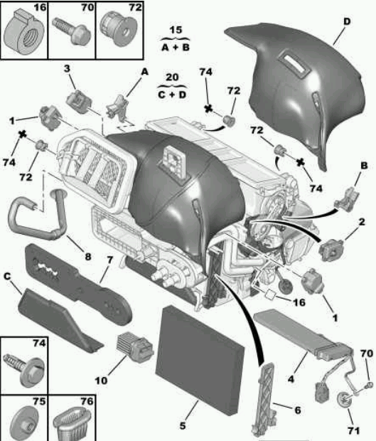

Jack - I've just noticed now that I have your VIN, that your car is a Left Hand Drive - so the component location will probably be as shown as per the diagrams on the driver's side - whereas the locations are on the passenger side for a RHD.
Here is an overview:
So item 10 is the Heater Motor Control Module
4 is the Air Heating Resistance Module

Thank for that, I've located the housing for the filter, but I cannot see the motor control module.
Do you have a little guide on how to get access to it? I had a look on Ciroen service but cannot find any :)
Cheers
jack
x 6948
Re: C5 X7 heater blower motor resistor location
Only what I've posted already in the previous pictures Jack. I can only assume it is tucked either just to the right of the pollen filter or above it. I agree it is hard to locate from that diagram.

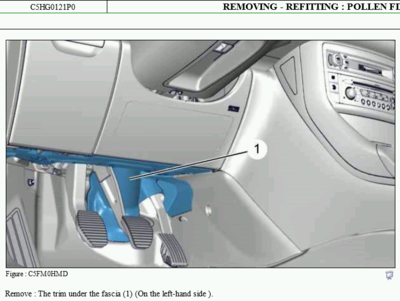

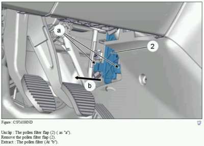

Jack - I don't think this is right - the pollen filter is on the passenger side too for a right hand drive - they don't have a different heating bulkhead / system for left / right hand drive vehicles so should be the same - either on the left or on the right hand side as per the diagram regardless of driving position. I've looked at the pollen filter removal procedure for my RHD and it states remove trim (left hand side) as per photos below:
