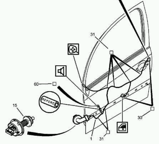

You can try the BSI reset first, but this sounds very much like a broken wire.
Do you have the Driver's sequential switch on your model (Exclusive usually)? There are separate wires - one for the 'UP' function and another for the 'DOWN' function, going from the Driver's electric window unit / motor to the electric window switch near the gearbox.
If you PM your VIN, I can check the speciific model wiring, but on the Mark 2 Exclusive (2007) the wire for the 'DOWN' operation is marked 6020 along the sleeve and the wire for 'UP' is marked 6010. So in this case if the window won't go down, it is likely to be 6020 that could be broken somewhere along the path from the switch to the window motor control unit. The likely and common place for it to break is near the plastic wiring tube protector from the door hinge side through to the door and will be encased in a protective plastic sheath, as per part 15 in the diagram below: I would start there and trace back / forwards for a break - it's the weakest part due to the door movement and the strain on the wires.
Edit: Just had a look at another earlier C3 and regardless off the sequential (on-touch) operation, the wiring codes are the same.
