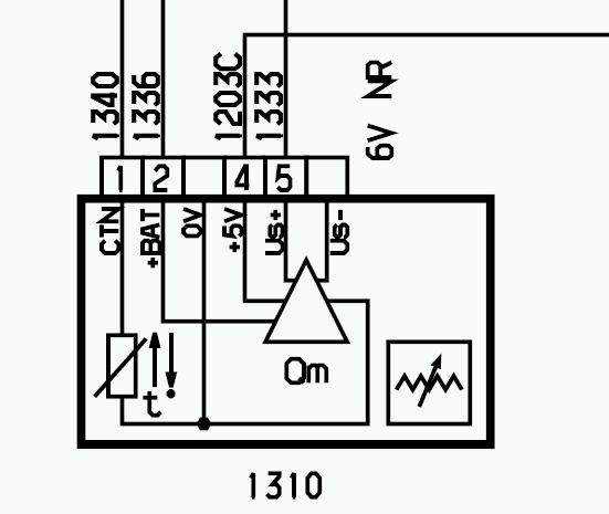

Can you post or PM your VIN - will need this to get correct diagrams for your car, however, the following is based on the 6 pin connector for the MAF on a 1.6 HDi 2007 C3:
From this, you can see that only pins 1,2 4 & 5 have actual wires going out.
Key:
Pin 1 (1340 = Air Temp at the Air Flow Sensor Signal)
Pin 2 (1336 = Air Flow Sensor Earth
Pin 4 (1203C = Injection ECU Power Supply)
Pin 5 (1333 = Inlet Air Flowmeter Signal)
