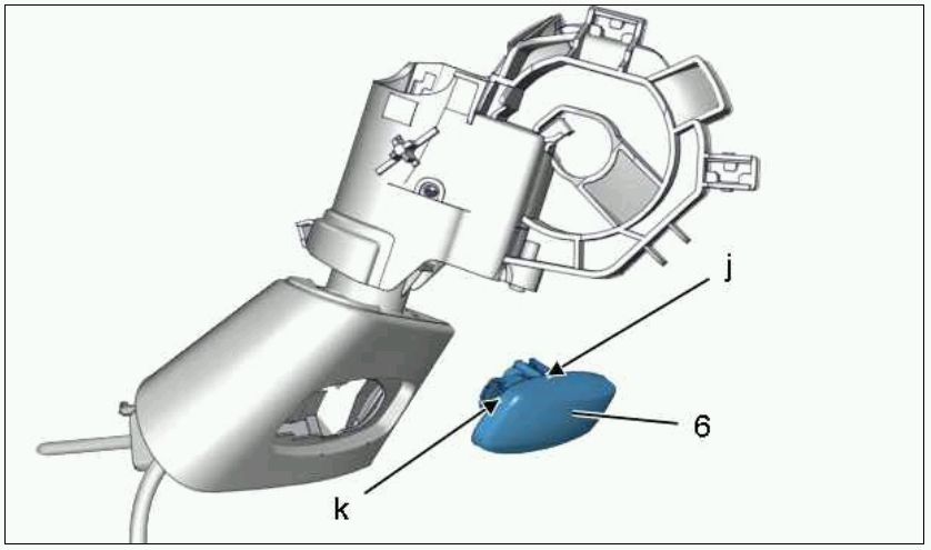

The motor unit at the back of the mirror is for adjusting the mirror itself - and I guess you have the info on how to remove all that. The other motor seeems to be called the 'Orientation Mechanism', identified as item 8 in the second diagram.
Unfortunately, there doesn't seem to be a separate part for this item, as you can see from the parts listing:

Thanks very much Mark. The diagrams are very useful, where on earth do you find them?
