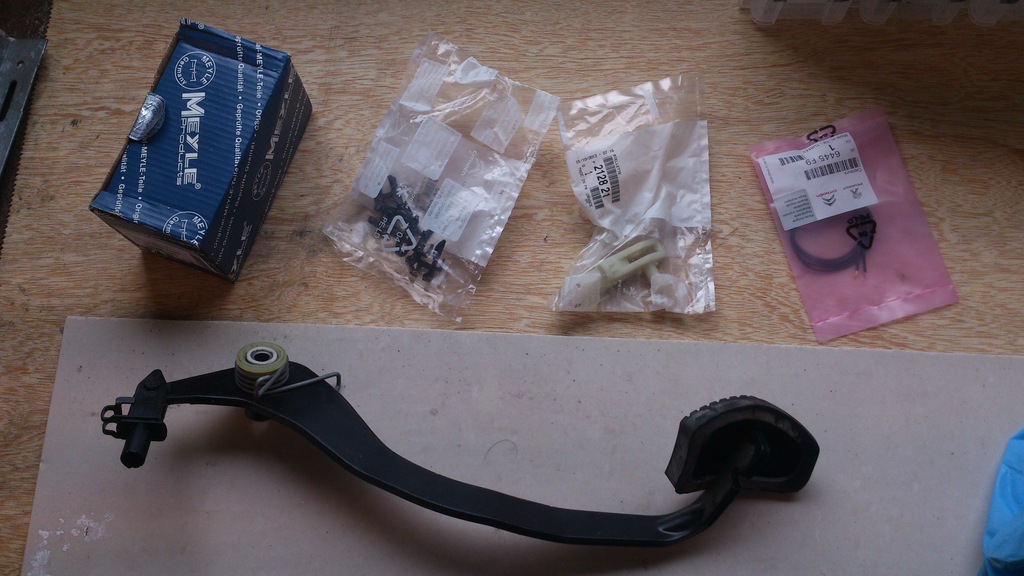

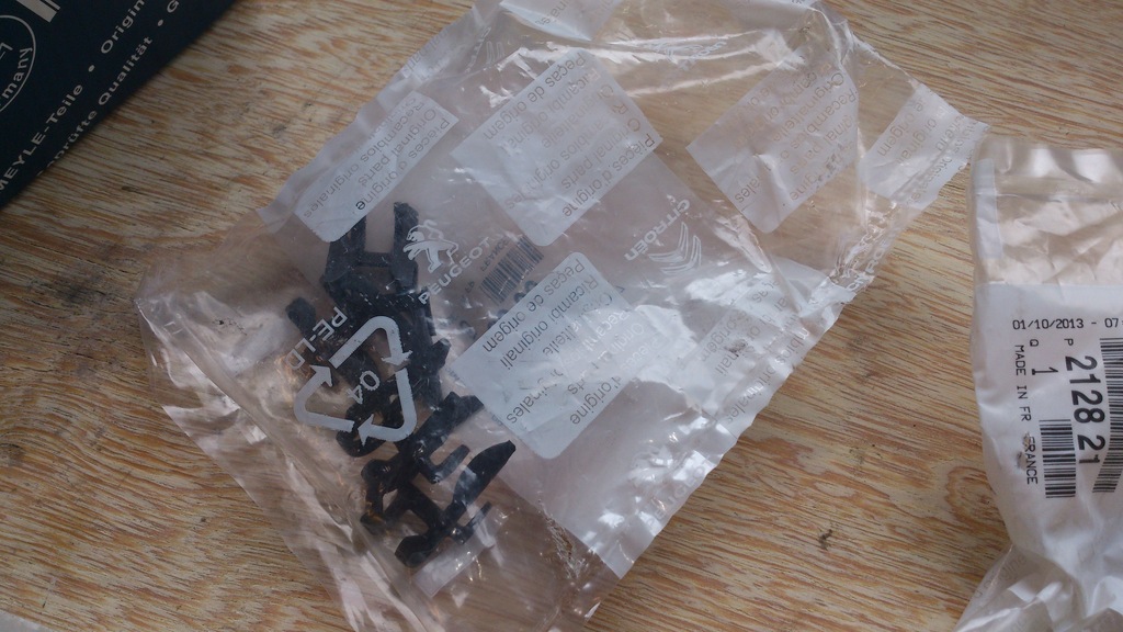

Well I have replaced the clutch clip (this is the third time I've done this horrific job) and as the parts place I collected a exterior temp sensor. Door card off again and another look, turns out the sensor was missing after all and the erronious readings werecoming up even with nothing connected. The sensor comes without connectors just cut wire ends. I think it's because the part is shared across many models and Peugeots also. I just tinned on a pair of spade connectors and heat shrink and plugged in once more and lo the temperature appeared and remained for the first time! Joy, it was 16 degrees here as I parked up.
Anyway, that bloomin clutch clip job! Despite doing this three times now and being assured by previous reports that the clip can be replaced without the pedal coming out I STILL can't do it like that! The pedal had to come out and then there's the stupid fact they fitted the pivot bolt from the brake pedal side. Again, I hear this can come out that way but mine simply couldn't. The brake pedal was disconnected from the plunger spring thing, switch connector removed to make more swinging room for the pedal, then the edge of the lip that stops the brake pedal moving even further bent it 90 degrees away to gain a further few mm and yet still there was not enough clearance to pass the bolt head behind the brake pedal, I even used a luggage strap to pull the brake pedal to the max and still not enough clearance. It would have needed a further 3-4 mm to clear it. Obviously tried the pedal the other way - moved fully to the bulkhead (carpet moved to give a further few mm) and same thing - needed another 3-4 mm at least so I don't get how this can come out this way without sawing it! So I sawed through the bolt and after an epic effort everything was out. It took ages to get the pedal back in complete with the wound spring, plastic bush, through tube and the new clip and metal fork but finally it was all back together and the clutch adjusted. I got the new plastic clip off ebay nut it didn't come with the metal fork and given the effort this job takes (me) I wanted to ensure the whole assembly was renewed so that included the metal fork. I had to order this seperately from AEP and this morning picking it up it came in a pack of 5. Not that expensive really but I only wanted 1.
So here's the bits I bought and the pedal removed:
I have a pack of clutch clip metal forks
if anyone wants one let me know! Just the cost of postage
The blue box at the left in the photo is a new ball joint - I ran out of time for that..

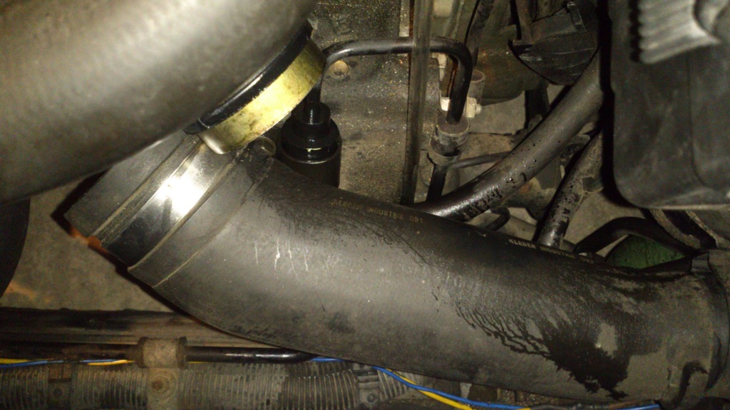

So! I hit the M74 south from Glasgow with the simple intension of bombing down the old '74 for a while and return after stopping for an expensive M-way coffee. That is what happened and I admit that I was travelling 'quite fast' at times.... but old katy took it all in her stride not at all feeling over stressed, temp gauges sensible and all that. I admit to 'caning it' and the hydractive suspension really does become very sensitive over certain speeds and seemed very firm with quite noticiable switch back to soft mode. All good fun Citroen joy so after annoying a few other hideous German 4x4s I called it a day and pulled off at Annandale water services at about noon. It was after I returned to old katy that pulling away I heard what sounded like a bit of exhaust blow. I thought I'd overstressed the old dear - probably never been above the indicated 80 before (Gold diesel VSX: old man spec you see) and I thought something around the turbo area had blown out but it drove ok up the slip road and the turbo could still be heard spooling so it wasn't jammed or anything.
It was only once on the M-way that I found there was no power whatsoever and the car struggled to maintain 70 on anything other than level. I wondered if the exact same thing that had happened to the silver hornet (previous 1.9TD I had) had happened here, a turbo pipe to the intercooler had blown off...? That would be relatively welcome considering the alternative diagnosis :- the turbo waste gate was stuck open or some other disaster with the turbo or manifold. It ran anyway so I nursed it home and when I got back I found this
Popped off right enough! The silver Xant had popped off too but at the connection up above the turbo where the rubber hose joins the rigid plastic one that routes down to the intercooler. Here it's popped off lower down at the intercooler. (though technically the same overall stretch of piping)
The mystery is that there was no detectable loss of power, no big 'pop' noise, I simply found the symptoms began after starting up again. On the silver car I was caning it along and lifting off the throttle saw a loud pop and a sudden loss of boost. I wondered if maybe the waste gate had stuck and it didn't dump the surge. But what happened this time?? All the hoses, rubber pipes etc were very warm so a slightly weakened jubilee clip would be at its most likely to lose grip ander those conditions but why no obvious pop off and loss of boost? Surely I woud have experienced it at the latest decelerating down the off ramp to that service stop. I had slowed on the M-way considerably before the off ramp though.
Anyway, all easily refitted with the jubilee tightened right up. But could this be a symptom of a bad turbo wastegate?

Other thought is that the intercooler could be blocked a bit internally (?)

Mine had popped off when I bought the car, think it wasn't used to a good caning! Gave it a proper tighten and has been rock solid since, even with extra boost.
