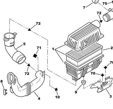

Stickyfinger wrote:This is fabric (No4) ?
I'm reasonably certain pipe 5 is metal braid on my cars, will have to check when home.
The more I think about the water absorbance theory the less I believe it.

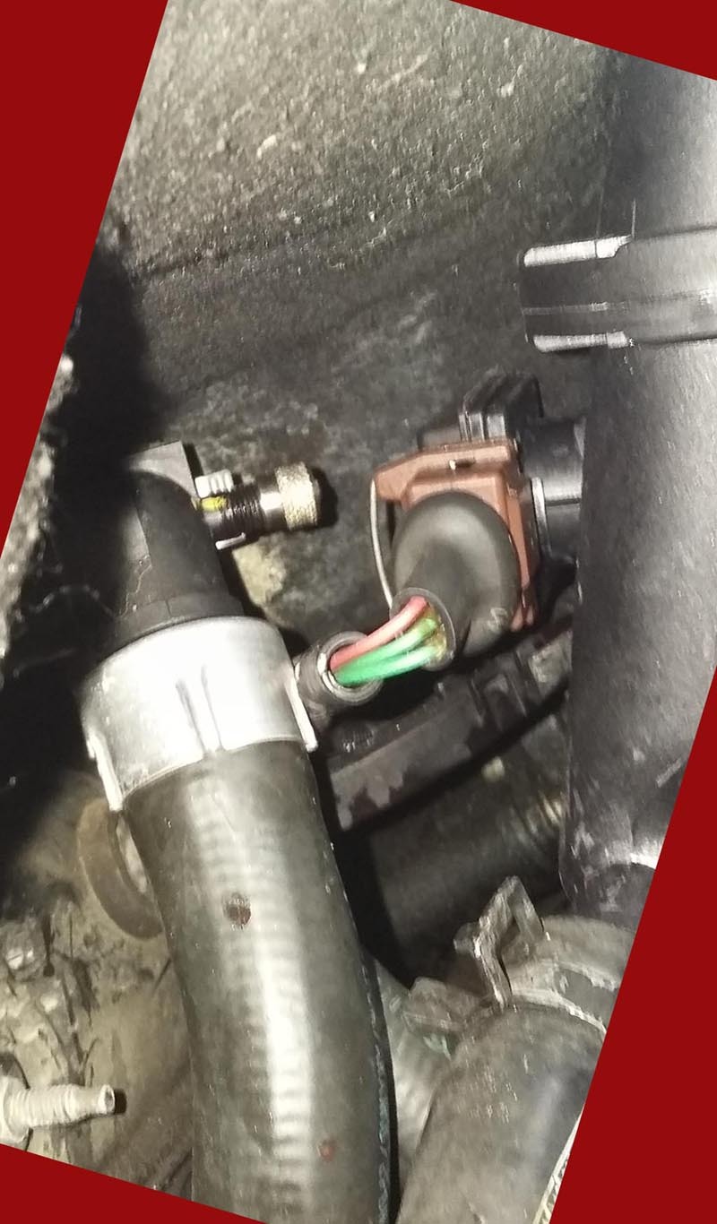

New header tank all fitted, RED OAT used and all ports vented of bubbles.
?? Is the little Matrix vent cap the same as a tyre valve cap ?? as mine is in the engine down in a dark place !
Will this happen ?

It's a bodge... Better to have an ally one made. It will then last a lifetime.

Stickyfinger wrote:Is the little Matrix vent cap the same as a tyre valve cap?
No, they have an o ring. Tyre valve caps are hit and miss weather they leak or not.
Xantia spare wheels are fitted with the right one, if you have an original spare check it. The caps shorter, rounder and has an o ring inside.

Unread post by Stickyfinger »
Will do....thanks James
I have some metal caps, the type with a valve screwdriver on top....will look at those as well

the cap needs that little o ring. i replaced mine with a cheap one and it split spewing coolant everywhere!

It has one inside.... is that not what you meant ?
Standard caps on spares BTW....would PTFA wrap on the threads do the job ?

If it has an o ring it should be fine.
Citroen and Peugeot sell them for small change anyway.

Stickyfinger wrote:It has one inside.... is that not what you meant ?
If its got the o ring and it's metal it's probably better, as long as the cap doesn't sieze on (dissimilar metals!)

Then maybe I will put a little liquid ptfe on the thread then....I have it for use on the radiators anyway

Citroen changed from plastic to metal a few years ago.
I had a plastic one blow off during the MOT and fill the pit where the tester was working with boiling water. He wasn't impressed.
I suspect it wasn't the proper one but a valve cap that had been substituted.
Passed the MOT anyway.
