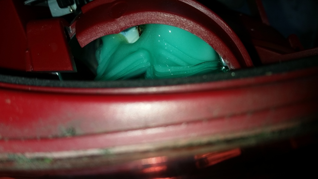

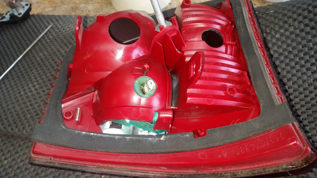

Hi I have a Citroen C5 VTX X7 Tourer 58 plate for the last 6 months. I have never been happy with the brightness of the reversing lights ,but have never done any thing about it. A few days ago I noticed that both reversing lights had stopped working. Once I removed the boot rear light clusters I found that I could not remove the bulb holder from either light cluster. Looking closer I was amazed to find that the inner "led" lens had comprehensively melted on to the reversing light bulb and set solid. With a bit of brute force and a dremel I have managed to remove the melted lens and bulb. Also had to remove some of the LED lenses as some plastic had melted across them The bulbs fitted were 24 watts not the 21 watts specified. I must say I am surprised how much the lenses have melted for only an increase of 3 watts. I did not fit the 24 watt bulbs they must have been fitted by the previous owner. Reversing lights are working ok now with the Led lens removed and the correct bulbs fitted.

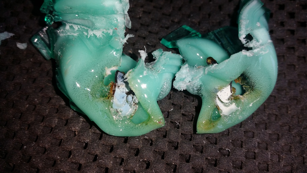

The remains of the two LED lenses. The white bits are the remains of the glass envlope of the lamp.
Side view of light cluster
Top view of light assembly
