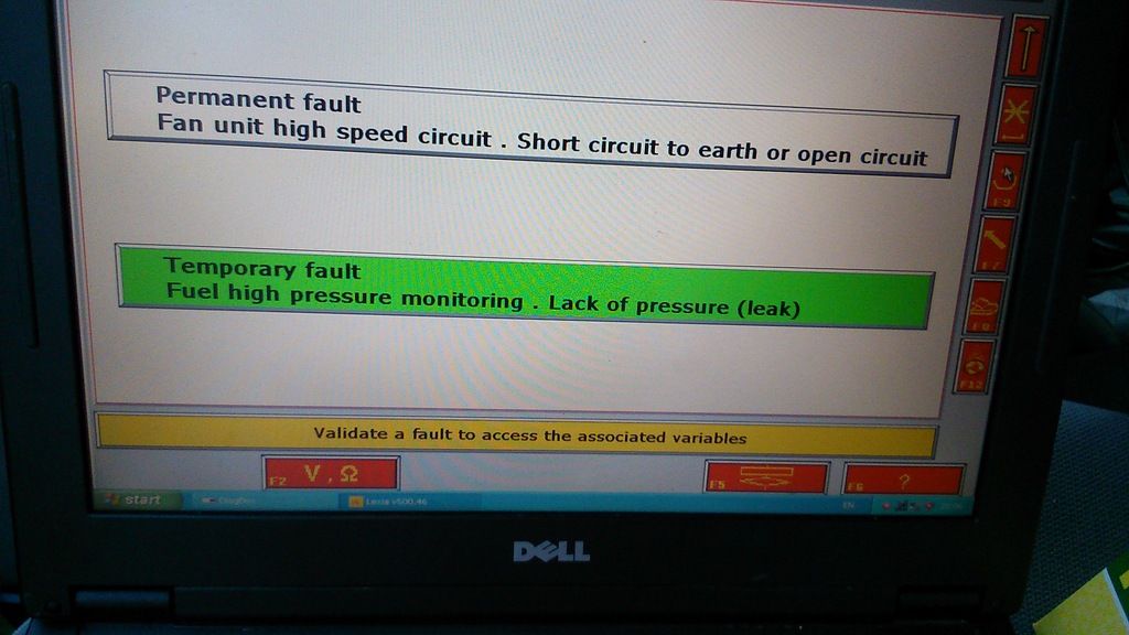

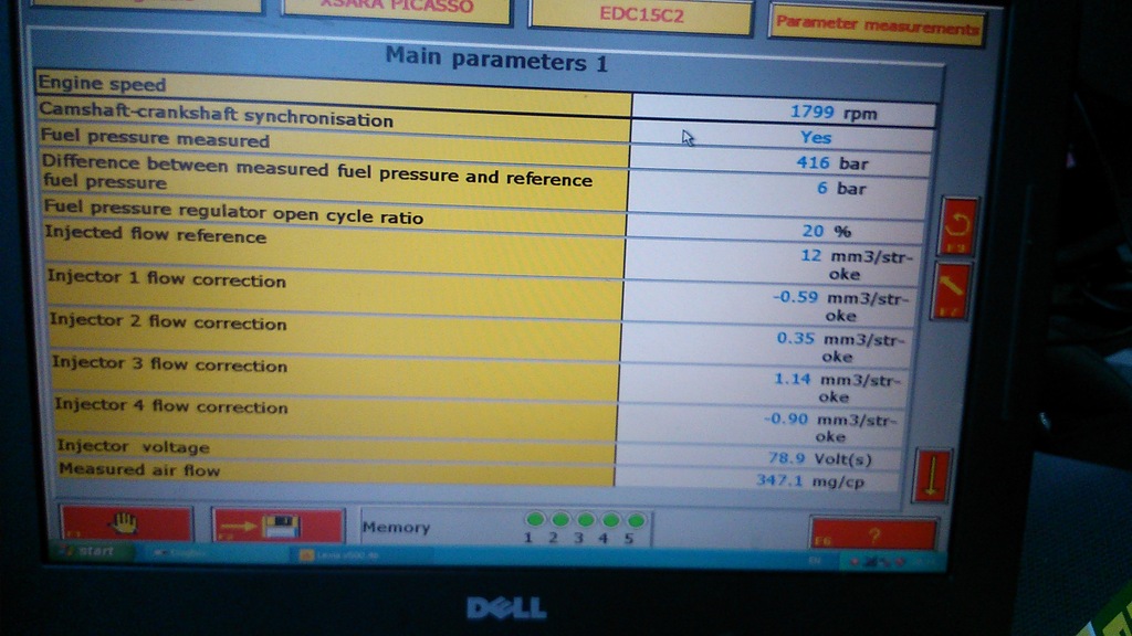

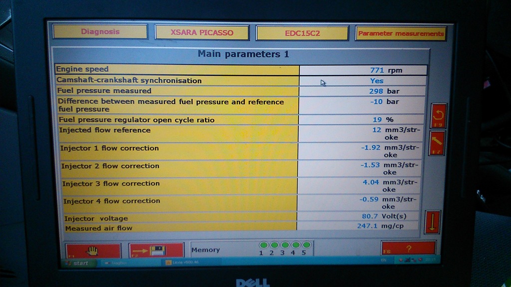

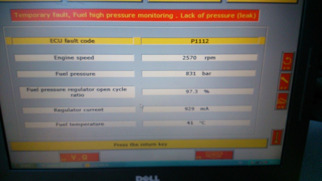

Hi all,
Got a friends misbehaving Xsara Picasso 2.0 Hdi 90hp on the drive. It idles ok, but using any amount of throttle causes it to mis fire and potentially stall. When it is running and on the road and use hard acceleration it will be either lumpy and cut out or you can hear the turbo spool and it feels like there is plenty of pull.
I had it on my lexia and took the following photos of the readings. When i tried all of the actuator tests, things seemed to be buzzing and whirring at the right time.
Being a musician I don't really know how to interpret these readings, so if any can shed any light we would be most gratelful.Image
With some revs
Fault codes
Many thanks

Thank you for the responses. Unfortunately he didn't realise his.mistake until too late and drove it until it conked out. They called breakdowns who emptied tank.and replaced with diesel. All seemed well after until now. Understand re petrol not having the same lubrication properties as diesel could cause problems with pump. We are going to try a different fuel pressure regulator tomorrow from one out the breaker yard and see if it effects the running. After spending time on Google the symptoms seemed to.match other people experiences. Does this seem a likely cause in.your opinions? Also had no idea a regulator was so.expensive, £167 from.GSF!

A sort of conclusion. We changed the fuel pressure regulator with one out the breaker yard (£4!) and it improved things no end. Not 100% but it is now quite driveable. Pulls well at speed and much smoother at idle. It is however, a little reluctant to start and can feel a bit jumpy when.pulling away slowly at low revs. I think the. High pressure pump might well be.on the way out? but I guess time will tell. Will update if there any further developments. They seem.happy for now and as I'm a musician not a mechanic I can go back there to playing my trumpet for a bit.

Injector 3 looks a bit dodgy, I would do a leak off test on them.
