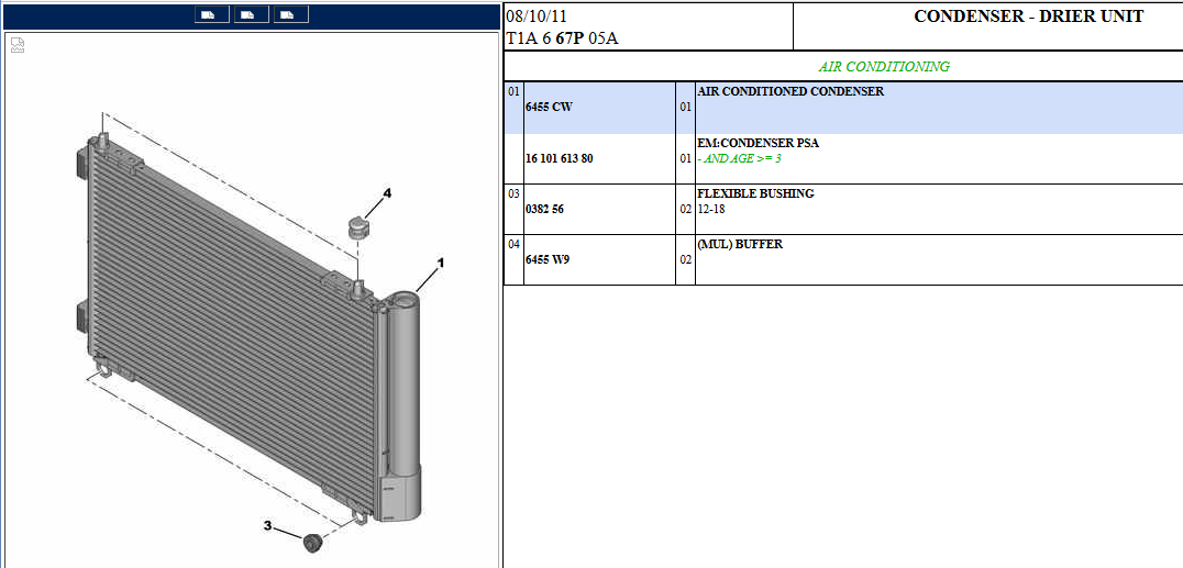

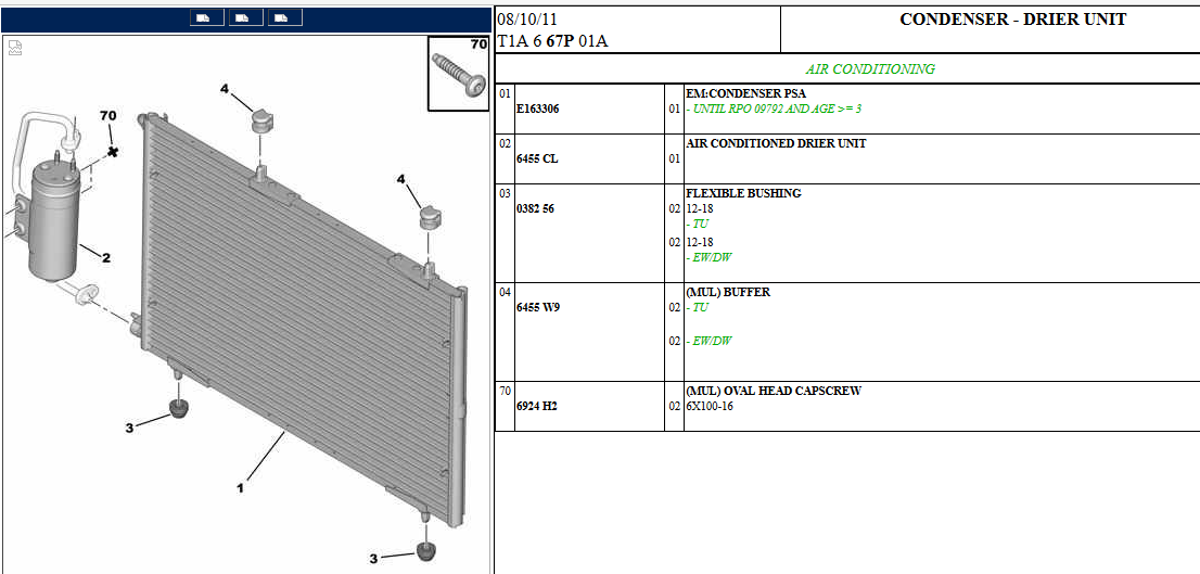

Servicebox indicates its a separate unit. Part is 6455CL for the drier um 'bottle' and 63306 for the condenser itself (up to 09792) , this shows the condenser and the bottle.
The other option does not show a bottle at all: 6455CW.
Can you not see the 'bottle' itself without much dismantling ? It does appear a separate unit.
EDIT... Upon further examination and thought, later ones appear combined, earlier ones (up to 09792) are separate... The description seems to indicate this. See pics of 'early' and 'later' ones...
Early:
Later:
Look on the right of the second (later ones) pic, the 'bottle' appears to be part of the unit itself, note the rounded shape compared to the earlier one.
Early:
Later:

Mine is definitely the lower one (the car is a 2006) and it very much looks all one piece to me.
Mike.
Mike.

I'd have to agree then (unfortunately) especially if the condenser in your car has the um, 'rounded' end at one end.
