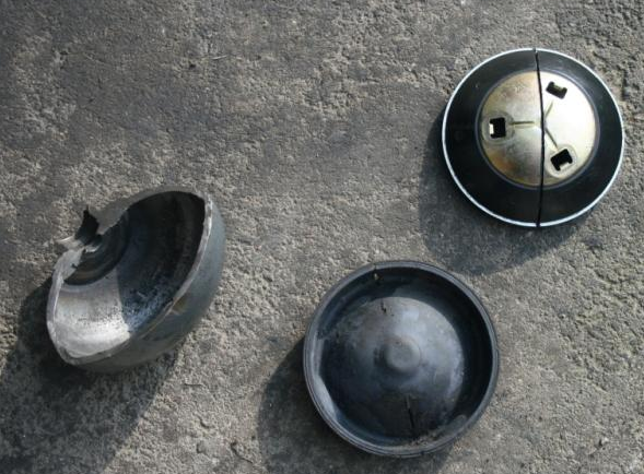

Don't want to go too off topic here, but looking into this Sphere issue - I was interested to find a couple of links to pictures of inside the Saucer spheres - in this case comparing an IFHS Sphere with a Citroen Original Sphere.
Inside an IFHS Sphere Inside a Citroen Original
The point being that according to the C6 guys the IFHS, MONROE and SUPPLEX saucer spheres are the same inside as the old green LHM spheres in terms of membranes and don't last as long as they still suffer with the nitrogen slowly escaping.
The Citroen genuine spheres have the newer membranes which seal better, reducing nitrogen seepage and allows Citroen to guarantee them for 5 years / 200k Km.
Guess I know which ones I'll be replacing mine with!
And back to the topic - no extra damping holes inside the sphere as far as I can see.

The spikes component may have been removed to show the membrane better - here's another pic showing the dreaded spikes!Stickyfinger wrote:So ?.....no "Spike" then
