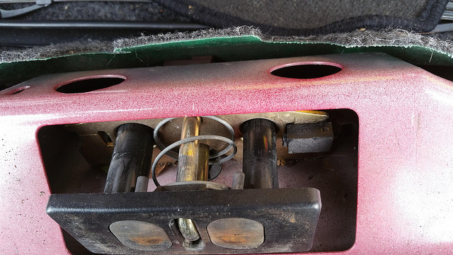

This is more often than not the boot switch George. It happened on mine...
The switch is buried deep in the hasp. Best to just disconnect it as it's normally open. You will find the brown connector just under the trim on the boot sill..
The switch itself is very tiny and breaks apart...

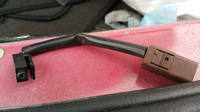

Jim, you were spot on, disconnected it, locked the car and the noise went in 30 seconds.. Very pleased.
Here's a photo of the culprit in situ:
2016-04-10 16.43.42
I removed the offending switch so I can remember to find a replacement:
2016-04-10 16.49.20
2016-04-10 16.43.42 I removed the offending switch so I can remember to find a replacement:
2016-04-10 16.49.20-

They can be difficult to find. My last Xantia had exactly this problem, which caused her alarm problems (until, as a stop gap, I disconnected it). I asked here on the forum if anybody had a replacement switch, and citroenxm came through with one.

Oh no... another NLA then...Hell Razor5543 wrote:They can be difficult to find. My last Xantia had exactly this problem, which caused her alarm problems (until, as a stop gap, I disconnected it). I asked here on the forum if anybody had a replacement switch, and citroenxm came through with one.
