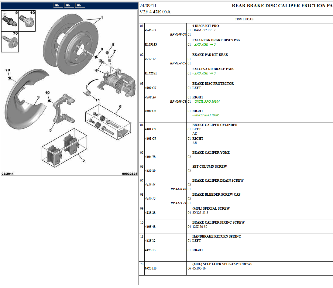

Its not listed although it is easier, quicker and generally safer to obtain a reconditioned / replacement one. A good motor factors will have one for you at a price a lot less than a main dealer would in most cases. If you did want to overhaul it again a factor may be able to obtain a rebuild kit for you.
My only point is ask what is in the rebuild kit before ordering or paying as it might just be a slide / pin kit rather than a seals assembly.
Quick pic:
Quick pic:
Andy.
