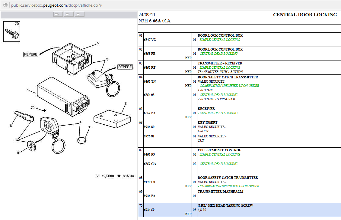

I was searching for a one button remote key at service box. Could you please check if it is available in the uk?
spider
- Posts: 3949
- Joined: 05 Jan 2010, 14:28
- x 77
Re: Peugeot 306 keys
The 'M Trick' does not work with the later ones. That was not what I meant though, there is another way.mixalis kal wrote:I was searching for a one button remote key at service box. Could you please check if it is available in the uk?
Its the same as the 405 / 106 units "order to match" for the single button ones as I thought it was. Item part number for the remote key is 655TN (you need the code from the roof unit) or to order a 'complete' set its 6552RT
I'm unable to check if its available or not though. Hopefully this helps ?
