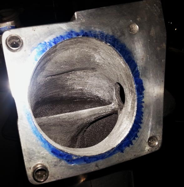

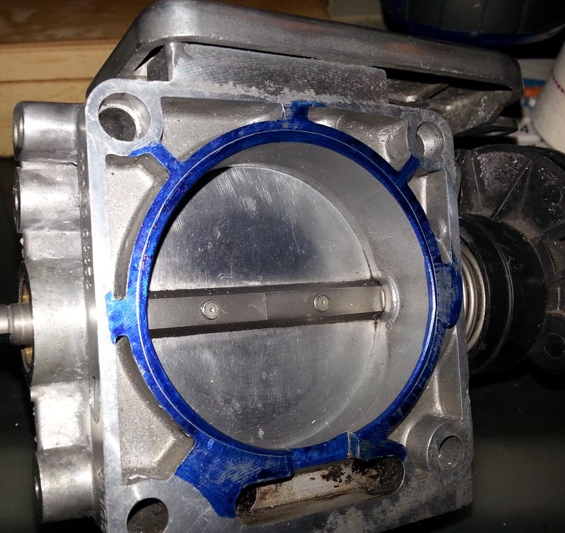

Throttle body enlargement and port matching under way.
Throttle body to Inlet chambers, note the large mismatch which is causing me a little head scratching at the moment. I cannot get an image (in my head) of what I can do with the throat mismatch [bottom left], I may have to get it re pinned.
Note the generally good surface except in the inlet area and the chamber splitter [or whatever it is called].
I with smooth to that area only and knife edge the splitter.
Any thoughts on the "bulge" on the side of the inlet chamber and why it is there ? [Note: shown at Top of the image, it also has a cosponsoring "cut out" on the outside]

Interestingly, the gasket is @70mm and the throttle body at 65mm.....the inlet chamber throat is between the two.
I do not really think gas flowing makes much difference and polishing I think degrades the turbulence within the chamber. I will just match the sizes, clean up edges and flash a bit but leave everything rough. The exception to that will be the inlet side of the throttle body which will be polished

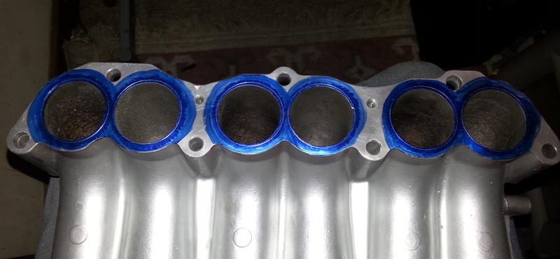

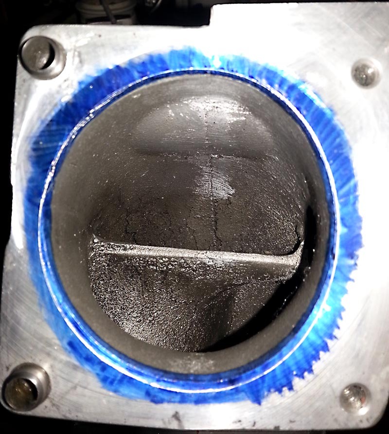

First rough cut.....
Before
Before
