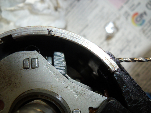

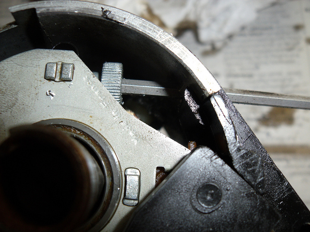

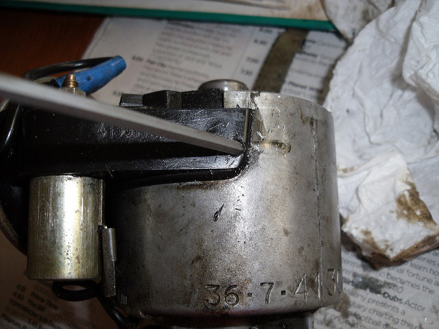

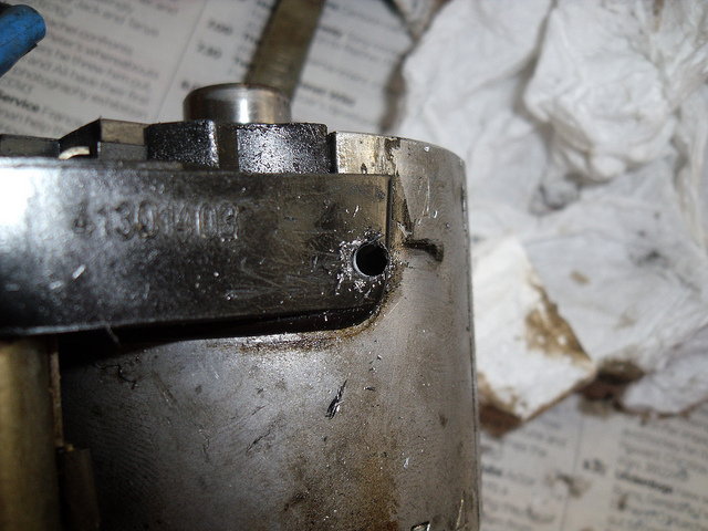

I find it harder...Stonehopper wrote:I find a little easier than the Ducellier. With a suitable hole drilled into the side of the dizzy, an allen key can be inserted to adjust the points using a dwell meter.
You see I had a SEV to start with, and started with no hole. That's great! So I drilled a hole.
Distributor modification 1 by macplaxton, on Flickr
Distributor modification 4 by macplaxton, on Flickr
Slid an allen key in...
Distributor modification 3 by macplaxton, on Flickr
Distributor modification 2 by macplaxton, on Flickr
All okay to that point. Then I found two problems
First the cap clip on that side gets in the way of the hole a bit. Then the inner wing gets in the way a bit too. Add to that a new cassette that lasted a grand total of 1706 miles and broke the day my eldest was born.
So currently the car runs a Ducellier.
