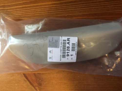

1) This is the part:
a_New20Part209128AR
a_New20Part209128AR

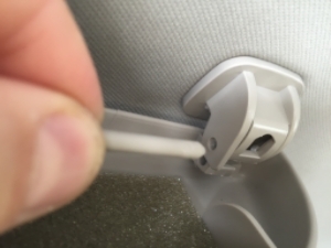

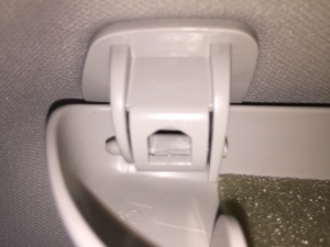

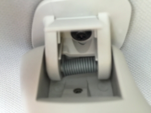

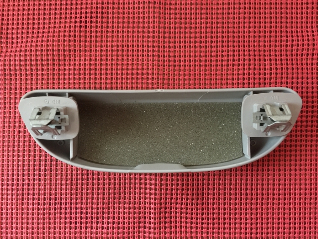

3) Lift the hinged mountings to reveal the king pin. Use a small screwdriver or your finger to push the pin through left to right (for the left hand one, right to left for the right hand one) and withdraw. Repeat for the right hand mounting.
b_RemovePin
b_RemovePin
4) Mounting with Pin withdrawn.
c2_PinWithdrawn
c2_PinWithdrawn
5) The mountings come with a securing bracket and screw already assembled as shown. We do not need the brackets as we will be using the ones already in use by the grab handle. We will need the new screws though.
c_Access to Screw
c_Access to Screw
6) Using your Torx 20, remove the screws and keep these safe. Keep the silver mounting brackets, but we won’t need these.
c1_Torx Used Later_1

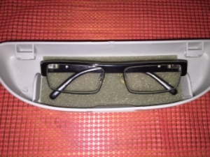

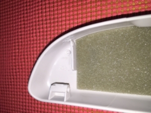

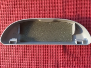

7) The remaining shell has a layer of foam at the bottom to protect your glasses. Before proceeding, now is a good time to check the case to see how the glasses you intend to store in it will fit.
My reading glasses were a good fit...
d1_Reading Glasses 2 OK

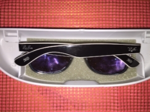

... but my Ray Ban Wayfarer sunglasses were a bit too wide. Although the left arm looks too high, it's actually the right arm that is being blocked by the right fin.
d2_Sunglasses Too Long
There are 2 plastic ‘fins’ in the case that I think are there to stop your glasses moving about. As I will be using the case for my sunglasses, I decided to lower one of the fins (the one that was affecting one of the arms), so I used a Dremel with a cutting wheel to make a horizontal cut at about half the height of the fin. I then sanded this down and voila:
After cutting one of the fins in half horizontally:
e1_Fin20Cut and Sanded
e_Reduce One Fin by Half
Glasses now fit!
e2_Now Fitting
e2_Now Fitting

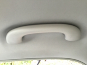

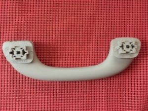

8) In your car, lower the grab handle and you will see a small plastic flap.
f_Grab Handle
f_Grab Handle
f1_Lowered Handle
f1_Lowered Handle

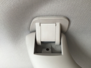

9) Gently lift the flap from the bottom up to reveal the Torx screw and remove:
f2_Lift Tab for Screw

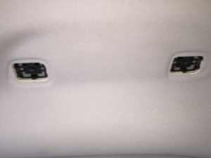

10) Repeat for the other side:
f3_Handle Removed
f3_Handle Removed

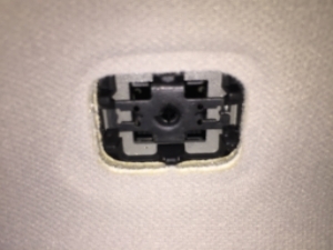

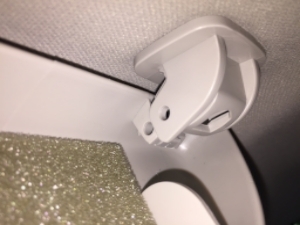

11) You can see here the original securing bracket which we will use to secure the new case.
e_Existing Mounting
e_Existing Mounting
12) Secure the new mounting hinges using the new screws. They will exactly fit the original footprint. The new screws are longer than the originals. To be honest, looking at the original screws that held the grab rail, they didn’t appear to go past the second thread mark, so I don’t think these would have taken much force! Therefore I used the new longer screws without any problems.

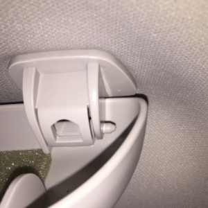

13) Once you have mounted the hinges, slide the case unit in behind and line up the 2 holes as shown:
g_Line up Holes
g_Line up Holes
14) With the holes aligned, re-engage the king pin. I actually found it easier to fit the pin to the right hinge with my left hand and the left hinge with my right hand.
g1_Insert Pin
g1_Insert Pin
g3_Pin Inserted
g3_Pin Inserted
g4_Repeat Other Side

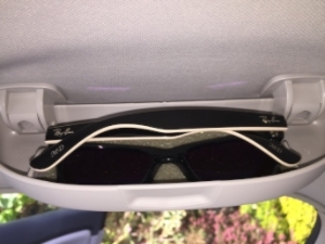

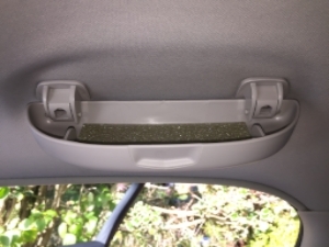

g5_Case Open
g5_Case Open
h1_Fins Stop Glasses Sliding

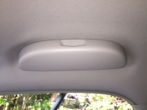

g6_Case Closed
g6_Case Closed
