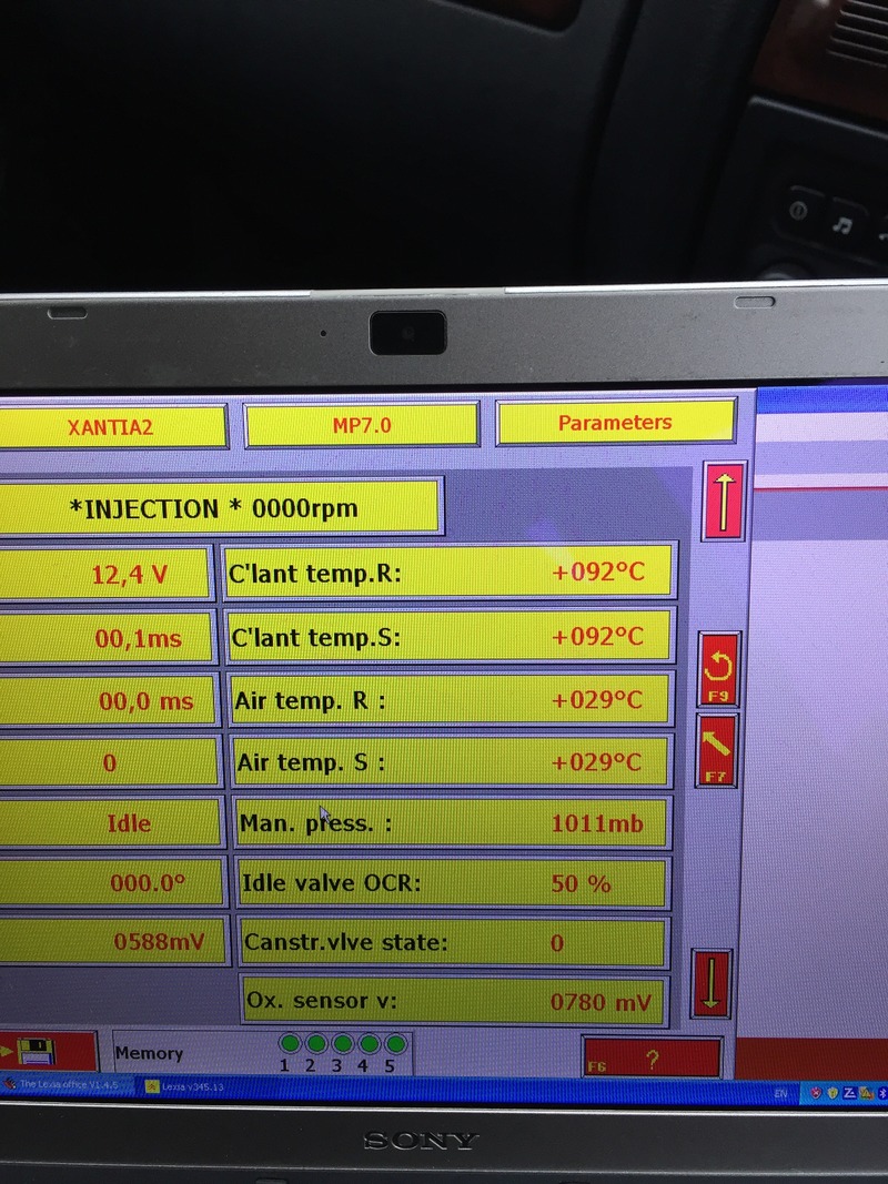

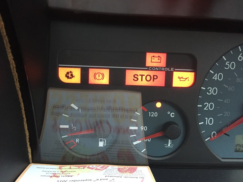

I've posted on this before but it still bugs me every time I drive the Activa as I was convinced it was running cold!
My temperature pin always tends to sit around 60 degrees, even after 70 miles of Yorkshire Dales roads at the Northern, and even after 200 miles home from the Northern this year.

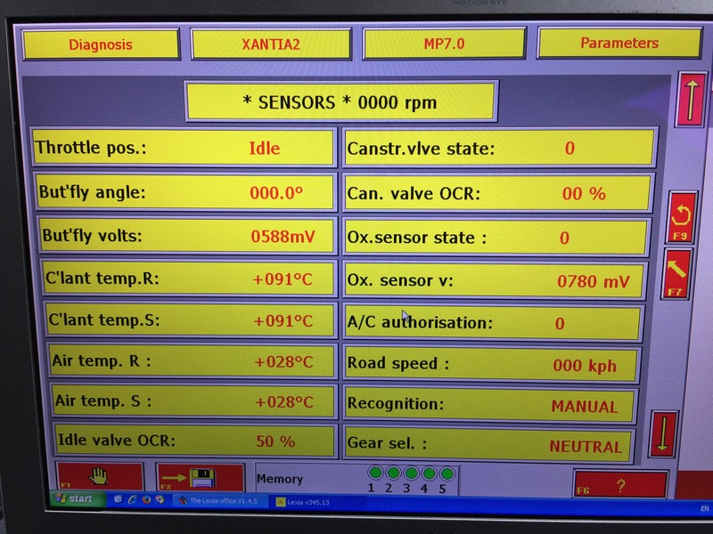

I popped out in the Activa today and after a bit of a spirited blast down the backroads I noticed the fans were running when I got home. I decided to get the Lexia out and interrogate the other temperature sensors on the car and see what they were reading. Lexia showed both of the other sensors at 92 degrees in both the Injection and Sensors screen within the parameter measurements, which is far more like what I would have expected to see.
I might be wrong, but I remember reading somewhere that there are 3 temperature sensors on the V6 engine, one for the ECU, one for the fans and one for the dial. Which sensor is it that runs the dial? I'm going to try replacing it with one from the spare engine I've got and see if the dial starts to read the same as the other 2 sensors do on Lexia.

DHallworth wrote:Lexia showed both of the other sensors at 92 degrees in both the Injection and Sensors screen within the parameter measurements, which is far more like what I would have expected to see.
Hi David,
Don't be fooled by the Lexia screen - the ECU (and therefore Lexia) only reads one of the three coolant temperature sensors - the green one at the front corner of the engine under the plastic cover next to the air filter box. The two different readings are "actual" and "substituted" values for the same sensor. (R and S)
Normally these two values will be the same, however if there is a sensor fault such as an open or short the actual value will show the "true" reading from the sensor (a crazy high or low value due to the fault) but the substituted value will be a "nominal" value that gets substituted when the ECU realises there is a fault.
The same applies to the air intake temperature sensor which has two readings but in reality there is only one air temperature sensor. (Yes I've looked for the "other" one just to be sure :-D ) In the case of the air temperature sensor if you unplug it the actual reading will be about -40 degrees C but the ECU realises this is a fault and substitutes +39 degrees C as a "guess" to let the engine run after a fashion. So actual is the reading that is coming from the sensor, substituted is the value that is actually used by the ECU for its fuel mixture calculations.
Regarding the other two sensors, one runs the fans and the other the dashboard gauge. On my new V6 the temperature gauge reads fairly consistently - and reads about 10-15 degrees lower than the Lexia reading typically. As others have pointed out here and elsewhere the two sensors read in very different parts of the cooling circuit so I think a reading 10 degrees or so lower on the dashboard is quite normal - typically I see about 80 or slightly less on the dashboard.
On my first V6 the dashboard temperature gauge was very quirky, like yours. For quite a while the reading would suddenly drop by 10-15 degrees in the middle of driving on the motorway then come back again, sometimes this would only last 10-30 seconds. I distinctly remember one night where I was on the motorway going up a steep incline and every time I accelerated the reading dropped 15 degrees then the moment I let my foot off the throttle the reading came back up again.

elma wrote:Is it possible that the sensor locations actually have that large a temperature difference? It's often reported that V6 Xantias under read coolant temperature. I think I'd get investigating with a laser thermometer before I tried to repair anything.
Reading about 10 degrees lower on the dash is normal - the really low reading David shows on the dashboard photo is not normal, that is indicative of a sensor, sensor wiring fault, or air pocket at the sensor.
Another possibility is that remember this is a V6 Activa conversion - I believe the dashboard is the original one that came with the 2.0 TCT engine - does anyone know for sure that the calibration of the dashboard gauge itself (a given reading for a given resistance from the sensor) is the same between a TCT and V6 dashboard ?! I think we've all just kind of assumed this is the case but maybe not...
