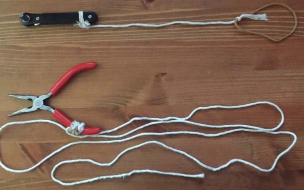

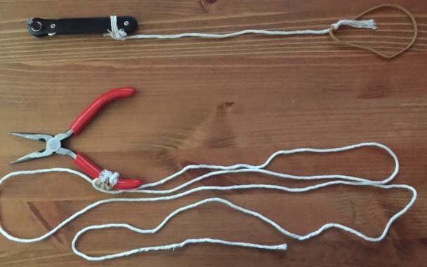

Well, I had a further 2 attempts to get these bulb holders out, but despite using some seriously Hi Tech tools to prevent dropping anything - it wasn't to be
They were so tight they wouldn't budge, despite trying the small pliers to try and get a grip! So decided to bite the bullet and rang up my local Citroen Dealer to get them to retrieve the bulbs for me via bumper removal and then to refit the bumper only. Now, putting great faith in the members here, I am hoping that getting the holders back in with the LEDs fitted will be easier by hand and won't require another dealer visit! The Service Manager did say they were pretty tightly sealed, but have greased the housing for me.

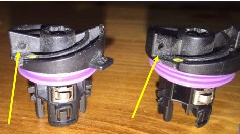

What I have done though, whilst waiting for the LEDs to be delivered, was to drill a couple of small holes into the tightening fin of the bulb holder using the trusty Dremel (arrowed in yellow below) - I'm then going to attach a small cable tie through each to make a ring-pull. Hopefully, if I ever need to replace / upgrade the bulbs again, I will be able to pull these out a lot easier after turning the torx a quarter turn! One further suggestion - I used a small screwdriver to carefully slide out the small metal contact tabs from the bulb holders (you can also see these in the picture below). I then carefully pushed each of the 'V' contact strips together to ensure that they will securely hold the pins of the new bulbs when inserted and maintain a good contact. They are easily slotted back in again. I didn't want to go through all this if the bulbs were going to work loose or have bad electrical contacts.
Roll-on delivery of bulbs, and hopefully a resolution next week!
Note - as you can see, these have the pink coloured seals not the blue ones - not sure what the difference is.

GiveMeABreak wrote: 11 Oct 2015, 12:57 Well, I had a further 2 attempts to get these bulb holders out, but despite using some seriously Hi Tech tools to prevent dropping anything - it wasn't to be![]()
OK, I promise I didn't laugh at the technical string!
Once they've been out and greased, I promise they will be easy hand removal next time. I wouldn't worry about the keyring things. Will probably just get in the way.

Well bulbs arrived, but still had to carefully cut away the little plastic stumps on the inside base of the holder, as they wouldn't allow the LED bulb to fit tightly enough.
Managed to get them both in - although before tightening up I did start the car to see if they came on - but nothing, so using my super ring pull technique idea
I managed to get them back out easily enough and check they were seated well enough. Seemed OK, but same thing, so I then realised
that I needed to tighten back up with the torx to engage the contacts. Once tested, got them both back in and tightened within 10 minutes.
Well - what an experience - I'm now formally off suicide watch although my forearms look like David Carradine's after branding himself with the Dragons from the coals off the 70s 'Kung Fu' TV series!

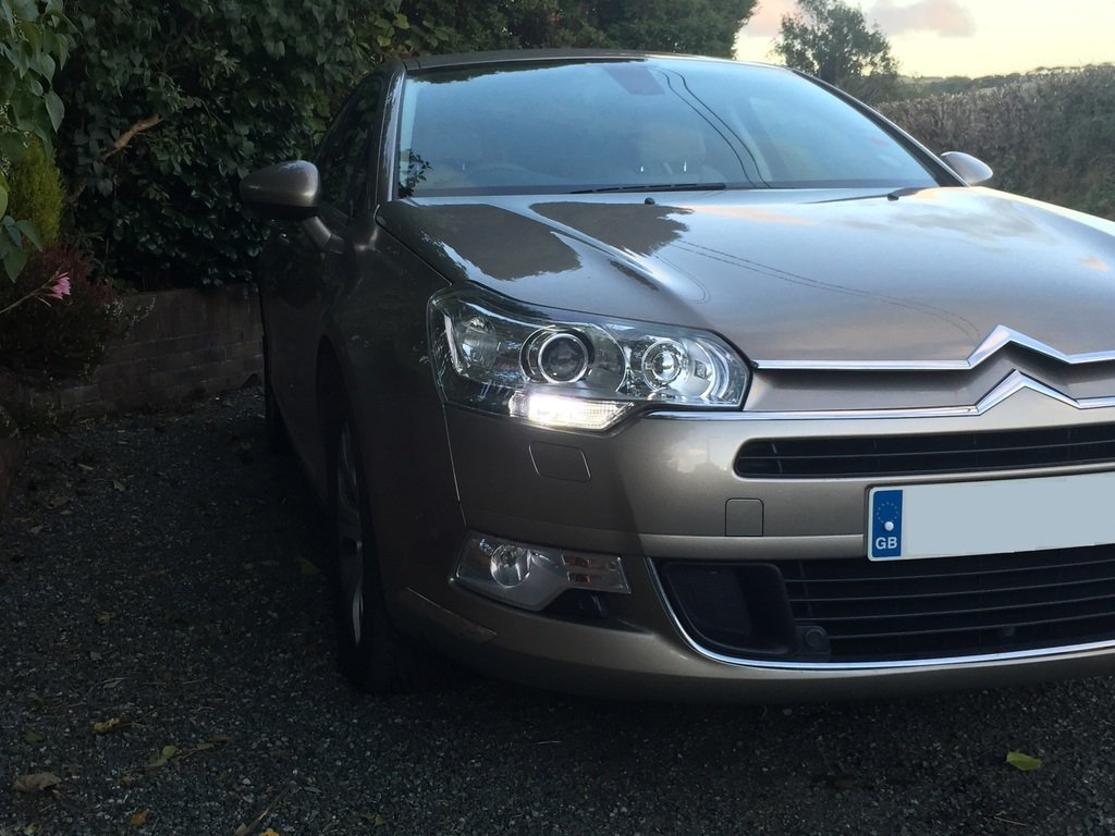

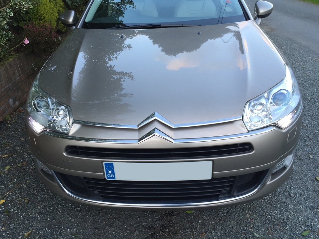

Anyway Pics below - taken in the sunshine. They look as I had hoped they would and think the 7.5W LEDs were the best available option. I used the 13m ones for reference.
Now - I'm looking at the HP19W Angular Lighting bulbs as the next project - but think I may need resistors on these according to Planete Citroen - and only once I've had my skin grafts! - Thanks to all for their help here

Looks good, but I have to say I will go down the remove the bumper road when I have one of mine blow...
Sunderas
- Posts: 35
- Joined: 24 Aug 2016, 09:29
Re: C5 Mk3 Replacement CANBUS LED DRL's
Fantastic job you've done!
