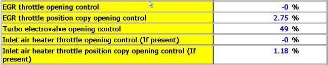

Re: Lexia parameters recording
Is this normal or indicative of a slight "leak" that warrants attention? While the EGR throttle (and Inlet air heater) is commanded at 0% the copy position always reports a slight opening, it never shows an equal 0%
I realise it's a miniscule amount (max I've seen is 4.13%) and am not overly concerned.
Answering my own questions again - I found a recording of the same parameters of a Pug 408 and both EGR and Air Heater copy positions obediently revert to 0% as commanded, which implies mine are not operating as expected.
Today I noticed a different hesitation symptom while the engine was still in the warming up phase; holding just under 2000rpm (for 30mph limit) I got a very uniform on/off power surge similar in frequency to the indicators flashing interval speed. ie, about 2-3hz. Typcially, I didn't have the Lexia monitoring the parameters and don't hold much hope of repeating the symptoms to do so but you never know.
Now, it was posted somewhere else that the EGR should not be operative until the engine has warmed up but what else could cause such symptoms?
Maybe it's too warm to tell but from cold (ambient) start, I can see my EGR is active. The hot air valve doesn't show any signs of life but once up to temperature, I have observed the cold air valve active.MikeT wrote:...it was posted somewhere else that the EGR should not be operative until the engine has warmed up but what else could cause such symptoms?
Perhaps it would be prudent to remove, inspect and clean all those valves (if present) as a matter of course. I'm thinking intake cleaner would be ok but what about the MAF, will the chemicals damage it? Is it right to presume the turbo could also cause the flatspot/hesitation if it's wastegate or vanes are sticking? Lexia shows it produces over 2000mb so it must be wanting to work ok.
