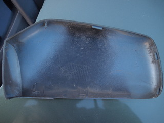

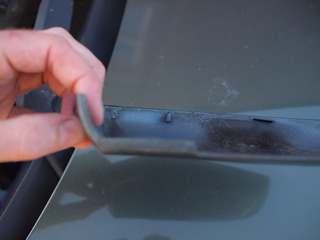

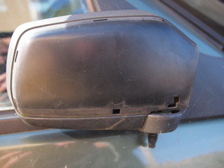

Heres the pictures.
I took it apart a while ago as the mirrors stuffed but the covers ok. Can't remember exactly how I went about it but I remember taking the glass out first, exposing the covers tabs. Possibly the lip on the inside (2nd pic) was unclipped next, I don't remember. As you can see 2 of my tabs are missing from the bottom of the cover so mine may have been easier than normal to remove. The other mirrors knackered too so I wish I could remember.
