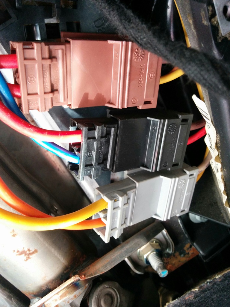

These are the wires coming from the ignition barrel. The circuits are completing as I turn the key. So I guess that's eliminated from the possible problem list.
The wires from bottom to top are:
Grey connector
Orange 12v when key in first position.
Yellow 12v when key in second position.
Black connector
Blue 12v when key in third position (motor start).
Red 12v constant.
Brown connector
Red (bottom) 12v when key in third position (motor start).
Red (top) 12v constant.
Is it the blue wire that goes to the starter motor solenoid control?
