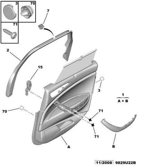

Can anyone help me with two rear blind hook for my Citroen C5 2008 saloon?

I'm not sure what exactly you're referring to, but I'll try to explain ... if you don't have the roll-up blinds in your car rear doors (this is an exclusive only option), it is not impossible to get them, but you'd need to replace the door panels and the window U cover ... very expensive ... unless you manage to find a broken vehicle which sells that for parts (but usually all 4 doors are covered, price range 500 EUR for a set, depending on the condition) ... if you actully have the roll-up blinds, and are asking for the hook, we'd need your VIN to tell you the exact part no. you need to buy ...

I am searching for the U-hook only, my C5 is an exclusive one and has the roll-up blinds. When I bought my car a month ago I haven't realized that these hooks are missing from both sides and that is why I would be happy if someone can find me two, because it is missing or it is broken on both sides.

Which exact part (number on the above photo) are you looking for?

I am looking for the number 7

Part no. 7467HT, it should be approx 6 € at your local Citroen Dealer
