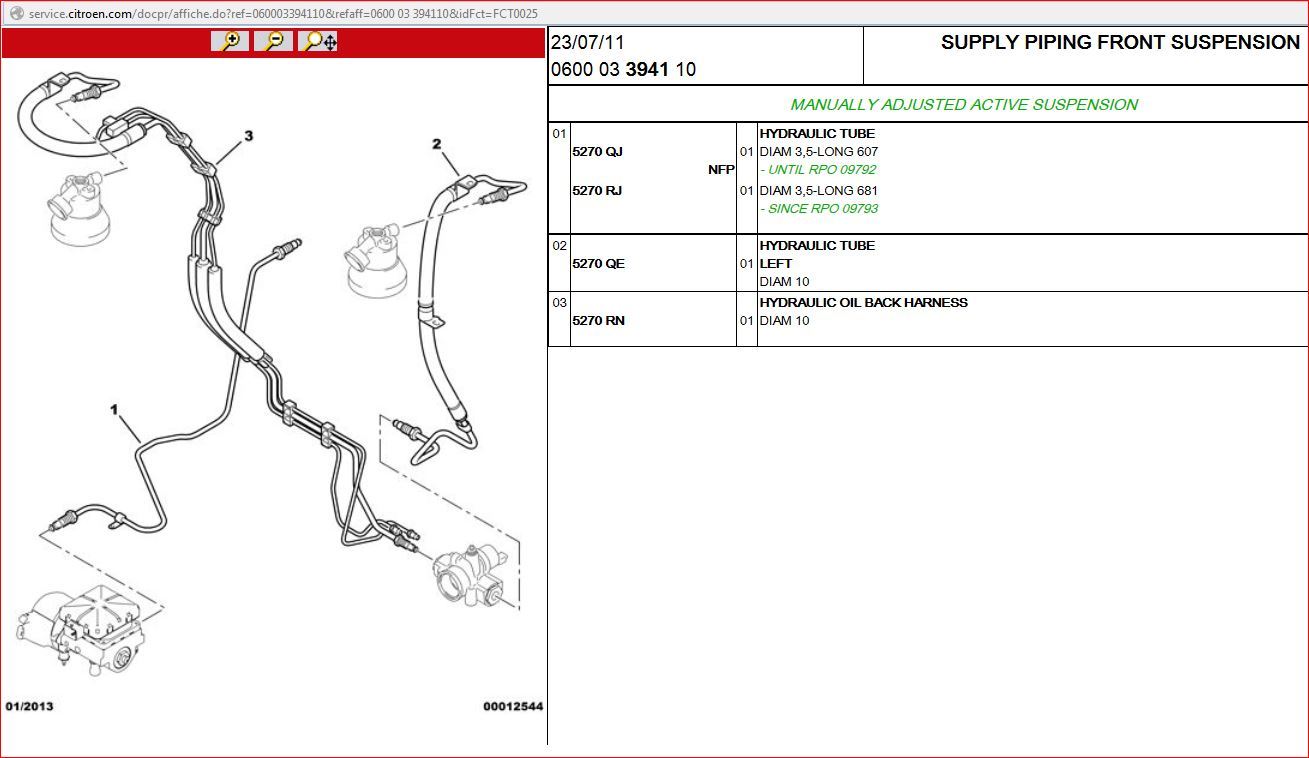

Acquired a front centre sphere from 2001/2005 2.2 HDI car and need some help on identifying various ports.
" onclick="window.open(this.href);return false;
These two ports are High Pressure?, I guess one goes to the pump, but the other???
Is this sort of detail covered in a Haynes manual???
Any hints welcome.
Cheers
C5 Front Centre Sphere

Re: C5 Front Centre Sphere
As on a Mk1, but looks the same on a mk2 as well
Thanks,
Is the schematic from Haynes?
It helps a bit more, but the pipes annotated "3" in the schematic go where ? as the pump is pipe "1"?
That schematic is taken from the Citroen on-line parts manual.
One of the pipes in the group labelled as "3" goes to the OSF suspension sphere (as shown).
The other 2 I would guess go back to the hydraulic reservoir (going on the description Hydraulic oil back harness)
