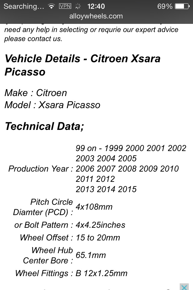

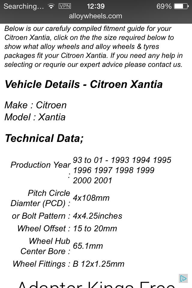

I appreciate that this may have been mentioned somewhere before! I have a Xzara Picasso going for scrap or spares. My question is can I take the wheels and tyres from it and use them on the Xantia estate (1999) I have bought as the tyres on it are worn? Plus, would the wheels from the Xantia work fine for the Picasso if the person who buys it decides to put it back on the road? I have compared the standard tyres and the pic ones appear to be a bit taller and thinner.
Advice appreciated guys, I do a lot of miles and need to keep safe!!

They're showing the same wheel specification on this site:
http://www.alloywheels.com/citroen-xsar ... loy-wheels" onclick="window.open(this.href);return false;
To check the rolling radius you need to compare the tyres using something like this:
http://www.willtheyfit.com" onclick="window.open(this.href);return false;
There may be a difference in the section (sidewall) of the two cars' tyre

If the tyres are one size narrower and one size higher profile they will be near enough the same rolling radius. I would swap them and then when you need new tyres go back to the correct size for the Xantia. May be worth checking with your insurance, as if anything happens your insurance may be invalid as the car has non standard tyre size. I have standard fiesta zetec 15" alloys on my fiesta van which only has 14" steels as standard. I informed my insurance and they added non standard alloys and I was not charged any extra. There is maybe some advantages to being an old git [emoji4]

FYI tried the wheels but the tyres are quite a bit different. The spare on the Xantia was ok so put that on the front so I have 2 with about 4.5 mm tread left on em. Fine until MOT in August. The pic wheels fitted the Xantia but swapped onto the Pic made the clearance very tight and as it might be used on the road decided not to swap them. Good thing was I realised the pads where worn to nothing so its in today getting new ones. Don't fancy loosing the brakes on the mway. Appreciate the advice guys!
