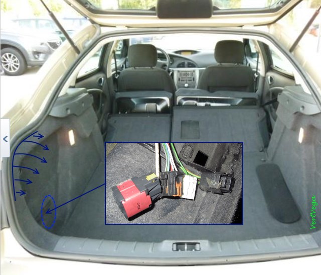

You're right. it usually does but not in this casePeter.N. wrote:A lot of problems can be cured just by disconnecting the battery for a few minutes, ...
mistuart, you're lucky that I've been reading and answering messages this weekend
I think I know the cure which costed me 155 EUR (it will be free for you
you this: Do you also have an Estate C5?

Re: C5 Wipers and lights turn on after 30 secs
I got this pic of a C5 II saloon from a car sale webpage and modified it.
cause of problem:
This is a symptom of CAN-bus functioning error which is caused by the corrosion at the end connector.
The connector made ready for the tow bar is one of the connectors. The interference in the CAN-bus "wakes up"
the BSI even if it goes to sleep after parking and can cause this very unique disorder
cure:
- Open/bend the upper left corner as seen in pic.
- Find the bunch of connectors (location as marked in pic).
- Clean connectors with some electric corrosion remover (circuit board cleaner, electronic parts cleaner).
- Dry out excess cleaner.
suggestion:
At the end I tied connectors together and fixed with a cable tier to upper end of the pocket.
This way the bunch of connectors would be protected better from water/humidity.
I hope this helps
cause of problem:
cure:
suggestion:
I hope this helps
mistuart
- Posts: 22
- Joined: 12 Feb 2002, 02:27
Can this cause the no start?
Will let you know if it cures it.

mistuart
- Posts: 22
Just checked the connectors and I don't have any corrosion cleaned them anyway but still have my problem.
Disconnected the COMM 2000 unit just in case it was giving out dodgy information but still the wipers and lights come on with it disconnected.
I have removed the BSI and think I will get it virginised then reprogrammed by the dealers.
Thanks for the advice I appreciate it.

VertVega
- Posts: 1178
- Joined: 01 Nov 2008, 19:39
- x 13
Corrosion cleaning woud have been an easy and cheap solution
Mine was solved like that in the dealers service. I forgot to mention that I had to buy a new battery also since it drained the previous one and I thought low/weak battery was the reason.
I still would focus on the CAN-bus disturbance since the symptoms are same as in my case (lights ON, front wipers ON).
If you have tow bar fixed clean also the tow bar plug next to the hook.
