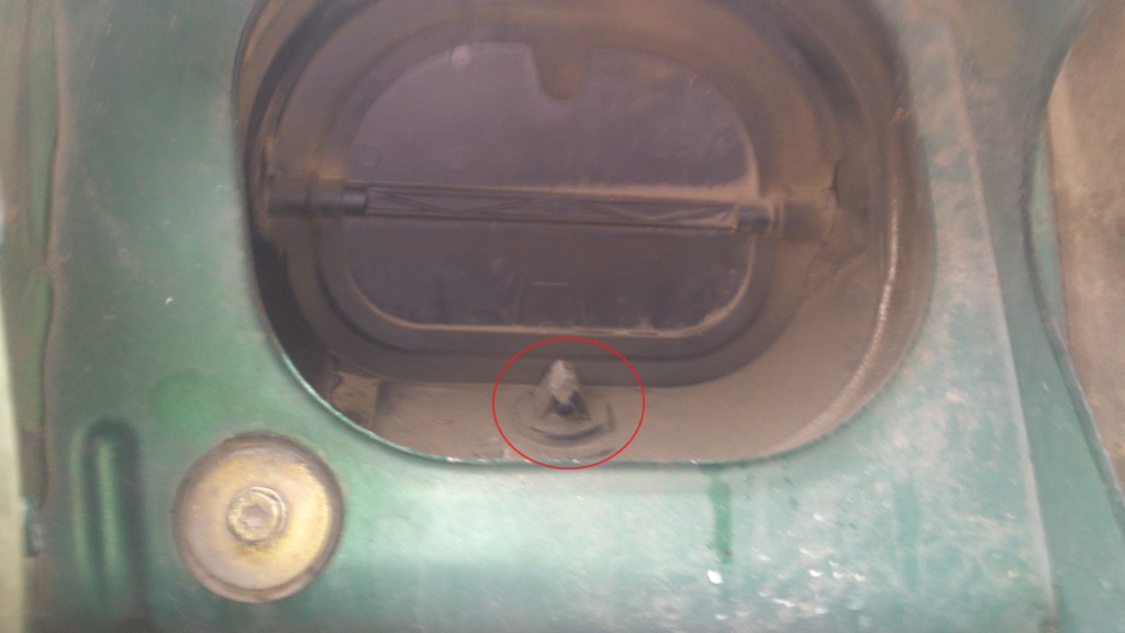

Hello Dave,
To check both flaps you have to remove the glovebox, but I think you should check first the pulling cable from the lever ( removing front panel).
Here are some pics since I changed the heater matrix.
