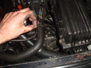

Any ideas where this goes to?
I want to get it plugged in before I play with the sensor.
It's dark and wet now so dinner time.

Re: Rev Counter and Turbo
Is there a spare plug behind the fuel filter? The brown connector two pin is useually the plug for the Cooling Fan HIGH Speed activation...
Just had a quick look, found a plugged in green one and black one both looking happy.citroenxm wrote:Is there a spare plug behind the fuel filter? The brown connector two pin is useually the plug for the Cooling Fan HIGH Speed activation...
No spare holes.
Will look properly in daylight though, sure something will appear.
I have a feeling it may be the reversing light switch plug, it reaches about the right distance to where the switch should be and the lights don't work.
Bulbs and both fuses are fine.
