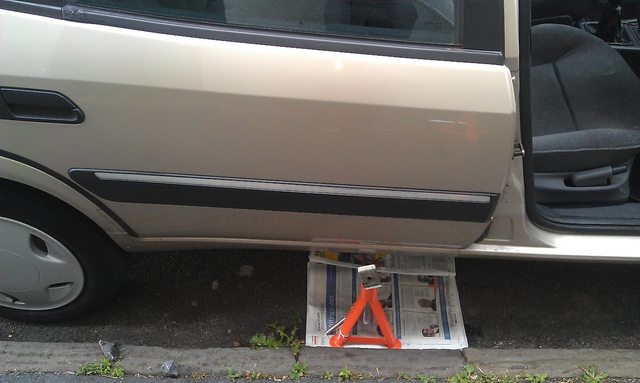

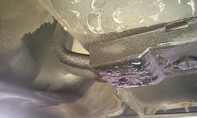

angle
- Posts: 21
- Joined: 23 Apr 2013, 08:44
Re: Xantia - LHM leak
I think you might have a point - I was looking in the Xantia Plumbing sticky and think I must have got the diagram the wrong way round and assumed the brake pipes went up the drivers side. Having gone out this morning in the light (and pacified the neighbour and attracted a small crowd of school children and binmen with some up and down suspension action) I've realised its coming from one of the pipes that look like they come down from the fuel tank.citronut wrote: yep silly me
so could it be a fuel leak with perforated ( whooooops shouldnt use that word round Jim![]()
) fuel lines
Leak is level with where the axle stand is:
And is coming from here:
So - fuel lines - difficult to replace on the street with a basic tool set?
Thanks again for your help.
Mark
- Posts: 12571
- x 1485
If you were to replace the entire fuel line (which that leak definitely is from!) it would be a trial. However, it's likely to be just a split there somewhere, so it should be possible to reapir it with a bit of fuel hose, some copper tube, and a couple of jubilee clips. Likely to be a messy horrible job though!!
Edit looks like there is a change from rubber to plastic / metal at that location. Might be that the pipe has just split, and can be cut back and reattached.

Oh Gawd it isRichardW wrote:Likely to be a messy horrible job though!!
I replaced whole rubber pipe from the metal end right to the pump but if you can get away with a splice for now then do but be warned that if the pipe has gone in one place it may well be perished and might let go in other places quite soon.
