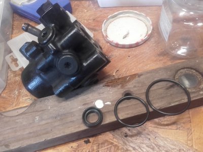

Hello all,I'm throwing myself in the mercy of you helpful chaps once again.I am now half way through reconditioning my hydraulic pump with a 30 euro set of O-rings.2 problems so far...the biggest being HOW THE HELL do i unscrew the six grub nuts and the two more hefty large nuts??!! I'm a fairly strong guy yet even in a vice using all my strength can't undo any of the nuts. Second problem is I don't know where two of the I rings even go . I attach a picture showing the old ring I need to replace but in addition there is a larger one and a strange kind of collar washer also pictured, I'm really thankful of all or any advice please guys. Cheers

Old o ring replacement,larger o ring and collar type washer *thingy lol

Afraide I can't help on the larger of the O rings, but the "collar" looks very much like a standard oil seal that would be used to seal a rotating shaft. On that basis I'd say it was the shaft seal that would go in behind the pulley (the one where you need to press the pulley off to replace).
Having not resealed a pump before I can't say this with 100% certainty, but it seems right to my mind that's what it'd be.

A good tip to help undo the Torx socketed plugs is to give them a sharp tap with a hammer before trying to undo them... They will be tight so use a good Tox bit and a breaker bar...
Ditto the 19mm hex headed ones... Be careful as under them is a ball and a spring that can easily go walkies...
