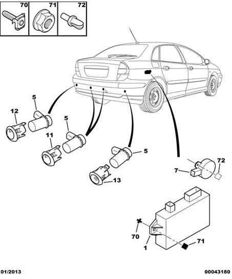

I gave it a quick look for the MK1 in the service documentation, the beeper (part no. 00006590[A0], or [17] or [A6] ... depending on the OPR ID) is located in the right rear part of the car, what looks to in the rear boot right side (wheel arch) ... the beeper is the No. 7 in the photo ... no installation details for the beeper, just for the sensors ...

Hi, thanks for the replies, the Mk2 may well use the radio speakers, but the MK1 definitely lists a separate sounder as a part, the description and operation in lexia says it uses a dedicated speaker too.
Now i looked that that same image on service citroen, but it seems a bit ambiguous, it could be in the back of the car, but equally that drawing could be interpreted as it being in the front left? The sounder shows screws coming through from the right, as if it's screwed to the left side of something. I did pull back the trim on the right side, but i'll have a look on the left too and see if there is a wire there. Mine is an estate, if that makes any difference.

The estate has the same picture ... the possibility that the perspective could point to the front passenger compartment is real, it was a long time since we had a Mk1 in the family, so I can't be of any more help in this problem ...

In C5 Break Mk1 parking assistance (single) speaker is located under left side (or wait, maybe it was right?) cargo space upholstery. It is mounted to a metal body frame, few centimeters below line of window.
P.S./EDIT: Speaker is marked as "7504". Picture is for LHD version - don't know if RHD is opposite.
