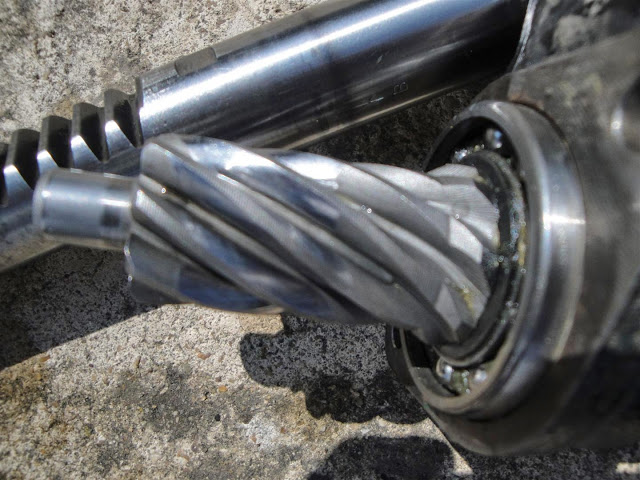

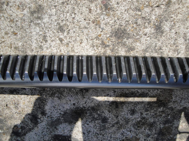

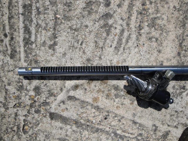

Having removed the rack and pinion, i'm not convinced either have a problem. They look in perfect nick to me and I can see nothing awry in the mechanisms.
Here are the photos. How does my rack an pinion look to the forum??

Well from the photos they look pretty good to me. You mentioned a knock but was there any discernable play.
