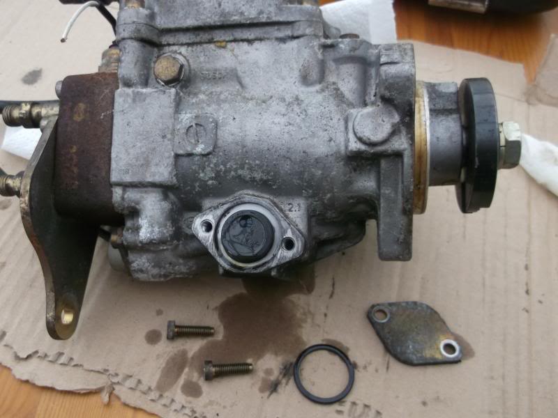

Good news! I've found the leak.
I have a spare pump from a scrapper that I used to inspect/take to bits/ruin and found this likely culprit.
Sure enough, after moving all the pipework and wiring out the way I spotted the drip-drip of a fuel leak. Unfortunately the seal that needs changing is completely inaccessible without removing the pump. Bah!
KP
- Posts: 3980
- Joined: 10 Jul 2006, 12:11
- x 27
Re: 2.5td XM, fuel leak! Bosch pump!
Good work Tim!
Have you being using veg long? It may be worth upgrading the seals to the better type that cope better with veg?
