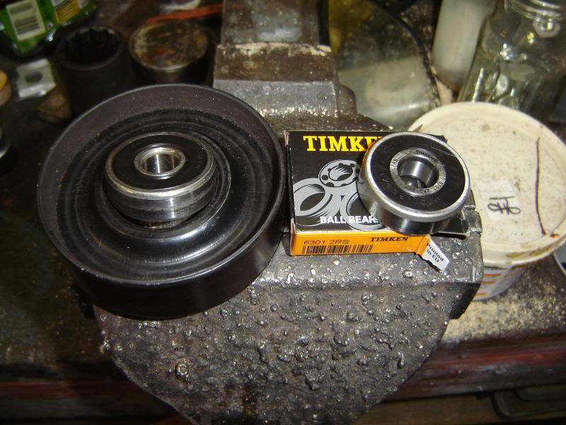

Auxilliary belt. As I suspected this was original belt and was worn. No aftermarket tensioner available. Price from Renault was£110. Took it off. Metal pulley wheel which was good. Noisy bearing. Took bearing number and sourced a good Timken bearing for 8 quid. Pressed old one out and new one in. All back together and running sweet. The power steering belt was good, not a mark, so I left it as it was the most awkward to get to belt I have seen. The timing is a chain, so regular oil changes takes care of that.

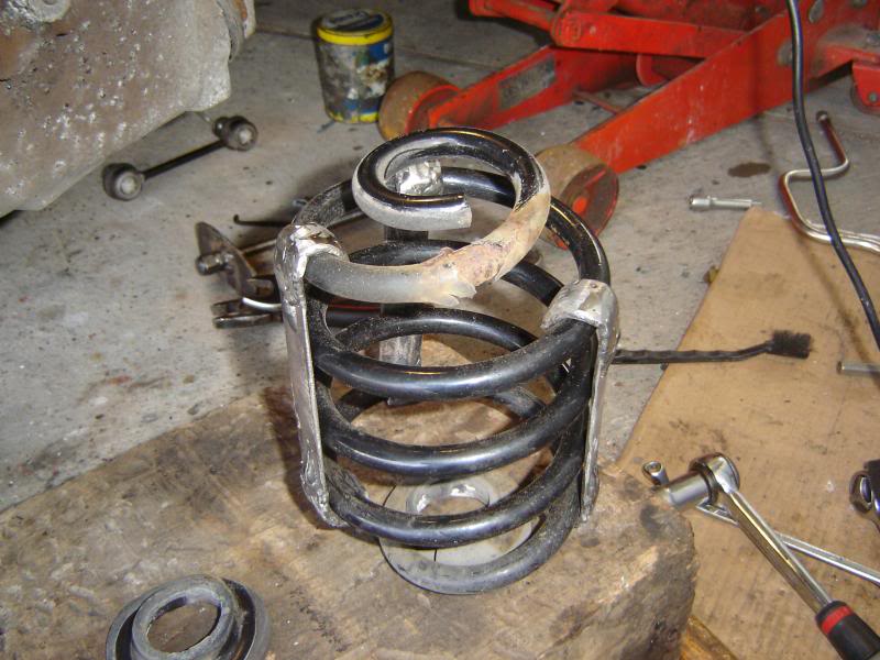

Well pics of springs in the clamps.
I managed to compress the spring on the car by jacking under the cup of swinging arm. I just managed to get spring compressed enough for my hooks to fit.........before car actually lifted off main jack. Renault use a long threaded tool that goes up spring centre to wind the spring up.

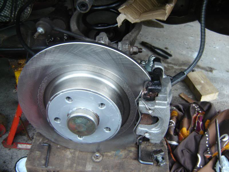

New rear brakes with bearings, ABS reluctor ring, caliper and pads.

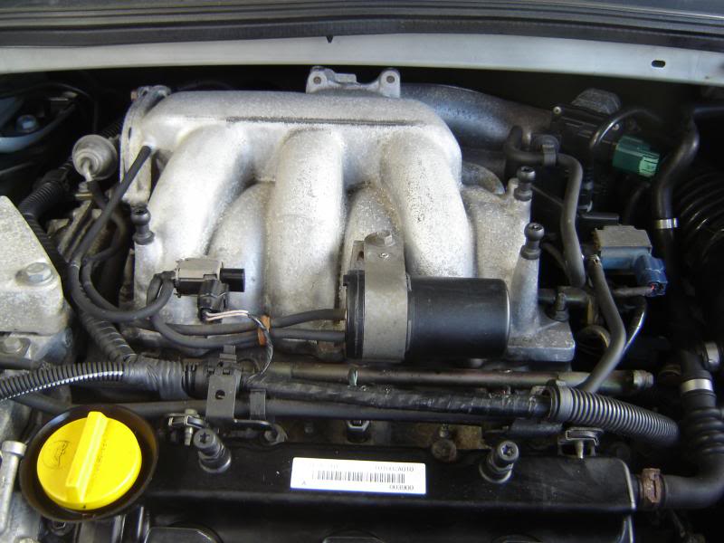

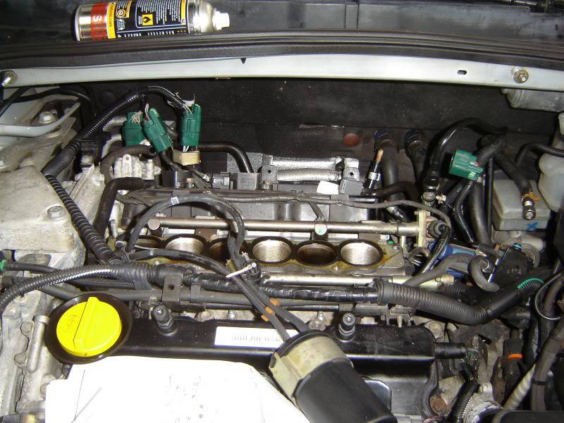

This is the plenum that is in the way for rear spark plug bank.
Then removed for easy access to plugs and coils.

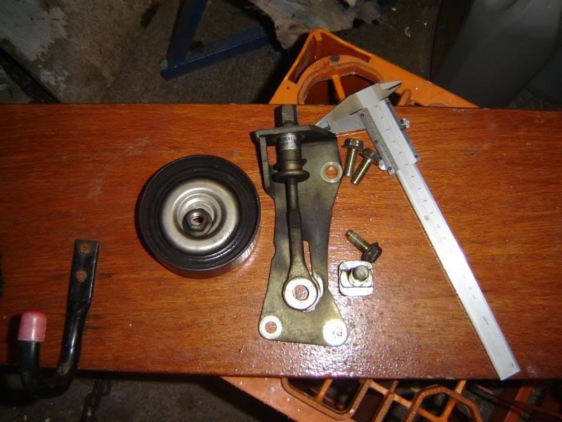

The pulley wheel and the new bearing.........that saved over a 100quid!
This was the way Renault were selling it and was the only option.

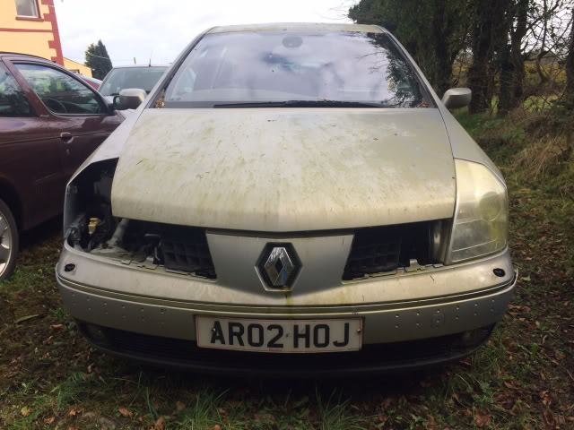

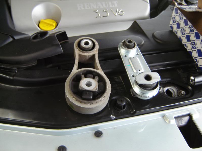

Managed to dig out an aftermarket lower engine stay as well.Mine on the left was sheared at the rubbers This pressed steel type is fitted to earlier models. It was about £17 versus the cast ally one at about £100.
