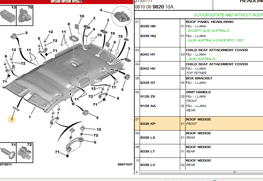

I presume it's a tourer? Looks like item 5 in the pic below - in which case Citroen will relieve you of only £2.42! If it's not that, then let me know where abouts it is in the roof and I'll see if I can find it. No idea what it is for mind you!!

Yes, looks like it's no.5 in that diagram. It is the tourer, btw.
'Box bracket'? I wonder what that is?

i would think the 'Box bracket is part of the head lining fixing to the main roof panel, although i can only see 3 No. 5's

Although the diagram above shows three, there are four, basically at mid points on top of all the doors.

The diagram shows 3 but the legend shows 4
The only thing I have above my doors are four grab handles. Could they be some kind of strengthening brackets for these?

Edit. On looking at the diagram again, the three child seat anchor points are shown as number 3, and there are only three shown because the front one is on the floor. (could that be right?). They are shown along the rear of the roof, nowhere near the midpoint of the doors.
