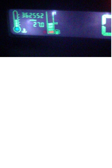

lol yes 362552 miles! i will attempt to upload a pic when i get home. :P currently in the car. :D

ok lets see if this works

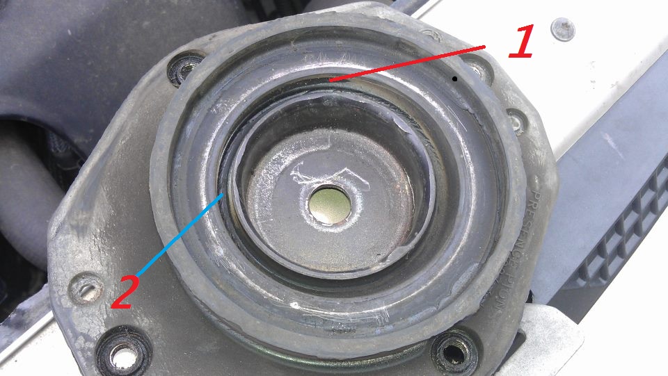

In a surprise helpful post from me..
This is my knackered Berlingo strut top - I'm sure that the Picasso one won't be much, if any different. The damage was hard to spot, when we checked and rebuilt the strut and we missed it completely the first time, and struggled to find it the second time! - You might want to show your mechanic this if they struggle. In the pic , the line with a "2" next to it points to the deteriorated rubber around the centre cup. This had been allowing the centre cup to hit the edge - the dark mark pointed to by line "1" shows the contact mark around the edge. I replaced the strut top and put a new bearing in, and the rattling and knocking stopped.
