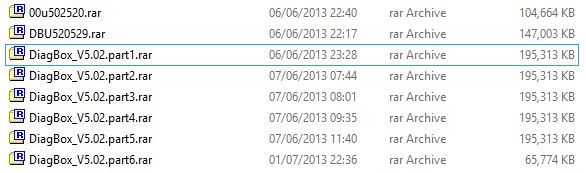

after loading Lexia on to 'new' laptop - XP, 15" ,plenty of RAM- got it work on C5.
then decided to upgrade to Diagbox, failed miserably, although it did get as far as the code activation part.
finally managed to get Lexia back on in a fashion, can't get past error screen which appears on start up.
Sooooo....back we are to trying Diagbox again.
download off Mega...is part 6 right, as in a lot smaller file?
i do have the other 2 files, txt document and Word.
now, do put these files as Zip on to the DVD as ISO or UnZip then as ISO onto Disc?
as regards install, whats the order? previous attempts resulted in errors saying the Temp folder wasn't available until next one unzipped, reached 6 to be told file was empty?
520 file first or straight into 529?
appreciate that there is an answer already here somewhere but would like to get this sorted if possible and maybe even offer as a name on the Lexia map, help the bretheren

Yes its normal for part 6 to be smaller than the rest. You'll want to download and install winrar to extract the rar files - open 5.02 part 1 and it will extract an ISO file for you. Either burn that ISO to a DVD, or mount it using an ISO mounting program such as Magic Disc. (I do the latter)
Before attempting to run setup.exe you need to uninstall Lexia - Diagbox comes with a copy of Lexia (to support older model cars) so if an older version is already installed it will clash.
Run the setup that is in the disc you mounted from the iso and you should have a working install of 5.02. After that you can optionally extract and run the 502 to 520 and 520 to 529 updaters one after another, launching Diagbox in between to let it update.
By the way, Diagbox 5 is a few years old now, if you have an early Chinese clone interface that may be the latest you can run but if your interface came with Diagbox 6 or later you should be able to run Diagbox 7.

i've got winrar already, ISO i can do as well.
sorry for being a Dummy but...do i extract all the files or just part 1 and thats 5.02?
so are parts 2-6 updates to get to 5.29
at the moment i'll settle for 5.02 working, plenty enough for me to lash up!
any way to tell which interface i've got?

Parts 1 to 6 are all the same archive - a so called multipart archive which is one archive split into multiple files for downloading purposes. winrar sees they are named the same (except for the last number) and is smart enough to join them all together and then extract the result. So no need to open parts 2 to 6 individually.
Together they contain the installer for 5.02. The other two rar files for the two updaters are separate though.
Telling what interface you've got - no easy way, if it works with 5 but not 7 its an old Chinese clone, if it works with both its not! No easier way unfortunately...
