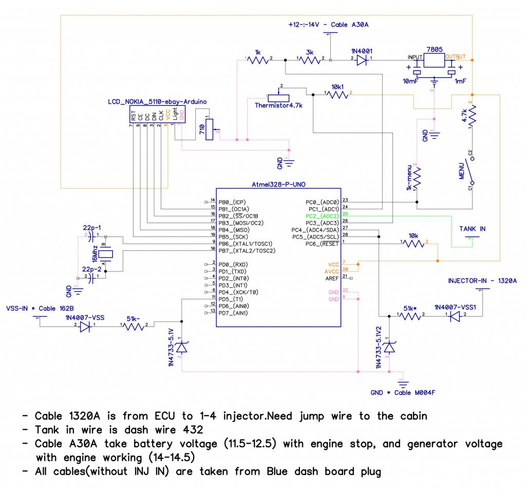

Now i need to check on the injector time - i "steal" signal from 1320A cable responsible for injectors 1&4. Well, just put wire from there to the dash. The used function was count pulse length with arduino command. Low part of the pulse is my injector time, High is the time between pulses , Low+High for 1 sec give me Hz`s or RPM.. Of course if you wish can be used other ways.. i choose that one as enough accurate.
Next signal was for fuel level - that was little problem. Why? Let me to start with the info that resistor attached to floated probe in the tank give 300oHms when tank is almost empty and 50 when full. That force me to add little more extra calculation. The next problem that i crash into was the fuel measure itself. For the dash arrow unit has been used some kind of logic to move based on start measure fuel level when the car is just started.Later on based on i guess only - vss, rpm, engine temp the arrow move down.So i decide to make something similar. The start fuel value is taken when you start the car from the same signal as for the dash meter. After it take every 10sec the current fuel consumption and to find average. That average consumption what is taken out of that start value. The result is shown on the screen as rest fuel level.
VSS signal - that is needed for the km/h to be shown or to be calculated L/100 consumption. I have already cable 162B which is VSS signal that goes in the dash.
First the sensor - thanks to the mate i get the info that it has 8 pulses for 1 rotation. From citroen service website i found that sensor gear have 18 teeth , and the shaft gear 22. Or that make 22:18 -> 1.222:1 ratio.
My car is fit with OEM size tires 185/65/15 -> (185*0.65)*2 + 15*25.4 -> 621.5mm -> 0.6215m * 3.1416 -> that give me 1.9525m for 1 rotation. If VSS make 8 pulses for 1 rotation so > 1.9525m / 1.222:1 > 1.5975m for 1 sensor rotation or 1.5975m / 8 pulses > 0.19969m for 1 pulse or if we round - 0.2m/per pulse. Well, that is good but other mate help with the idea that n the car dash the value of the tire length in my case is not 1.95m but 1.9 Why? Because when is with load the measured radius from the axis center to the ground will not be 0.6215m / 2 -> 0.31075m but less so the if i take 1.9m as tyre lenght -> 1.9 / 1.222 -> 1.5545 -> 1.5545 / 8 -> 0.19432 m/per pulse -> * 3.6 to go to m/s -> 0.69955 -> 0.6996 < that is my variable or if i have 100hz signal as pulses * 0.6996 -> give us 69.96 km/h If you wish to try, take the VSS signal to some suitable frequency measure device and make 70km/h on taho and check if you have ~100Hz signal.. With that 0.6996 as constant for calculation and straight hardware frequency counter if i make 50, 60,or 70km/h on dash that is what i see on my test menu in that car trip project.

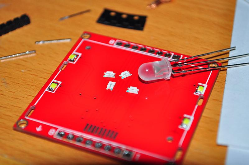

The next was small things as thermistor added for showing inside cabin temp, replacing the small blue backlight of that LCD with green ...

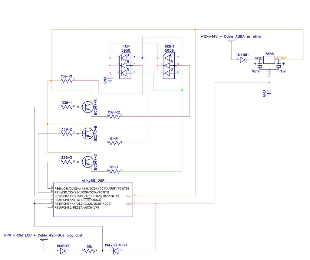

and idea for small RPM counter backlight change. That was made with other Attiny chip which control 2 RGB SMD LEDs. There the problem is that dashboard have green folio on top and is not possible to play with the colors. So i decide only combination of red+green => yellow -> dash green - > just normal backlight look. I found that the top led need to be for sure with red light on to have the arrow fully bright. Well that was not problem. The next combination was red+blue -> magneta -> + dash green -> that blue color. The last red led(right backlight) kick in to make the RPM counter red zone brighter.
In case of interest here are the diagrams:

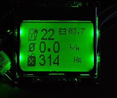

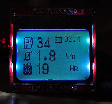

And the result is:
