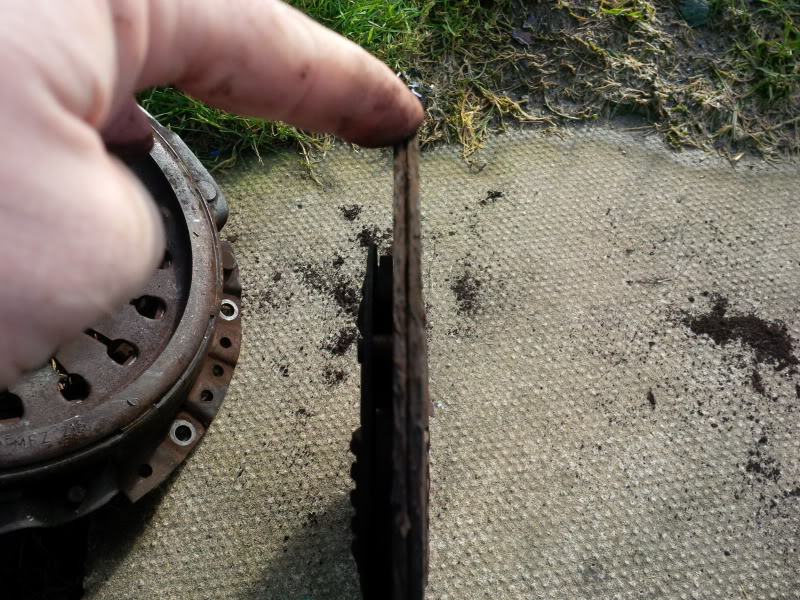

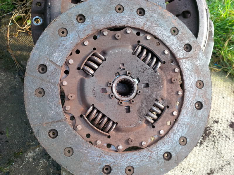

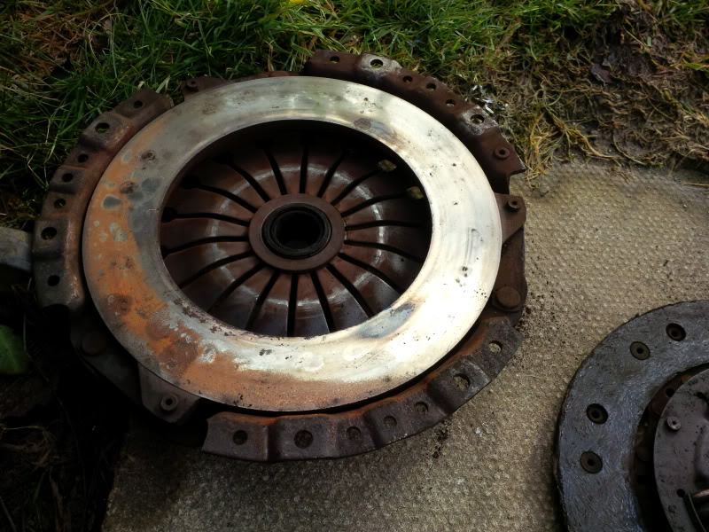

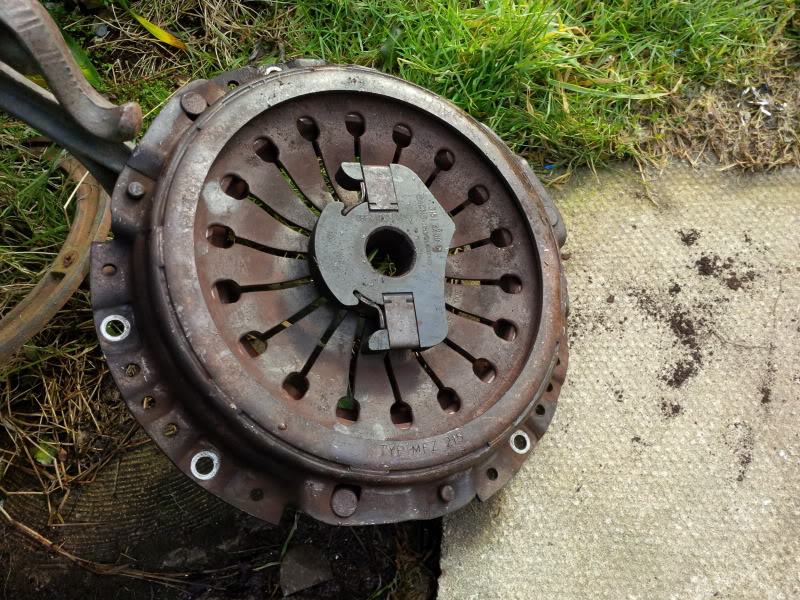

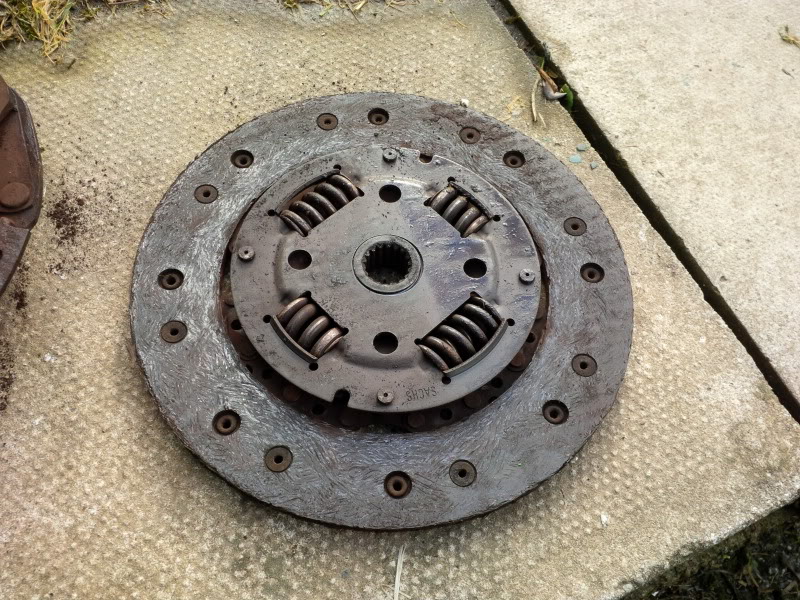

pictures of the clutch,
its been sat in the shed since last week and hasnt been carefully strored ;-)
the old clutch pedal was stiff and judde3red a lot on pulling away, bight was at the top of the pedal too, towards the end it would slip in any gear as soon as the turbo boosted up, wasn't far off barely driveable! (most roads to the village are Up hills!! ;-)
the new clutch is a valeo, the pedal is lovely and liught and the bight at towards the bottom of the pedal, no juddering at all, just a light slip between 2800-3200rpm's noticable more in 4th and 5th,
i think for the sake of £30 i'll get a new cable and fit that later this week, then its a bit more done for peace of mind!!

Wait! you put that Scachs clutch in???!!!! :shock: Surley not! Its not suprising its slipping if thats what you put in!
