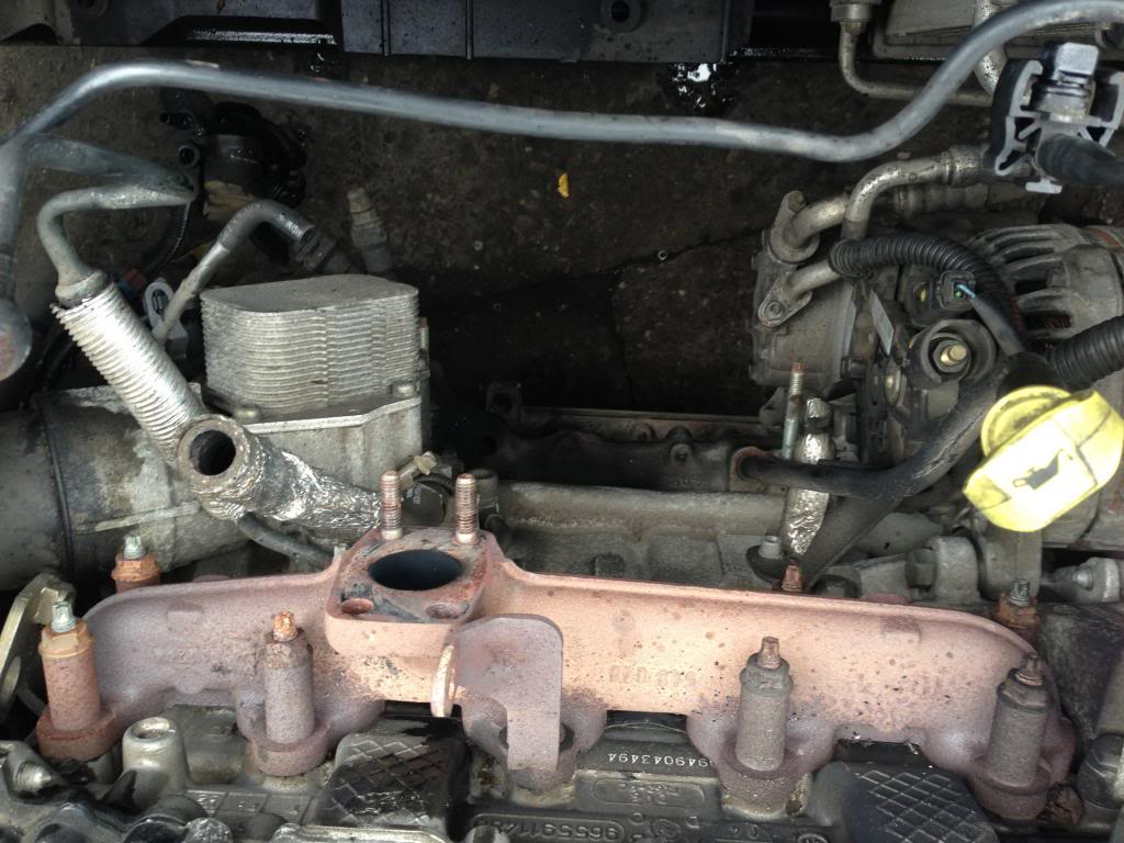

You just see the bottom of the filter cover on the left of this picture (courtesy of Lighty :-D ) - about 2/3 of the way down, under the turbo oil feed pipe (the one with the silver foil on it!). Turbo and DPF removed for clarity :rofl2:
Be aware it's a filthy job, the filter clips into the lid, and needs a good tug to pull it off. Fit the new filter to the housing - ensuring the spigot engages, and then screw the lid back on (not as easy as it sounds!).

I Guessed the Size of the filter head.. bear in mind Light's picture above is back to front, and taken from standing on the engine, not in front of the car.. :-D :-D :-D
