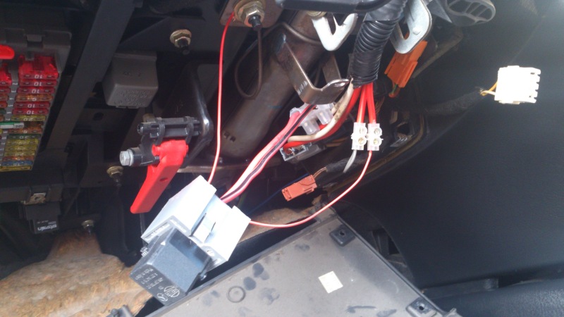

I changed the conection for relay on the second wire of the grey plug from the ignition switch and seems that increasing rotation speed of blower fan when I press break pedal have disappeared. I watched on the electrical diagram and the bigger consumer seems to be the break lights, 4 * 21w bulbs plus additional grid 5 * 5w...in total of 109W or aprox. 8 Amps consumption.
Next are some pics with the relay and the car last summer.
Thanks all for your help and Happy new year!
