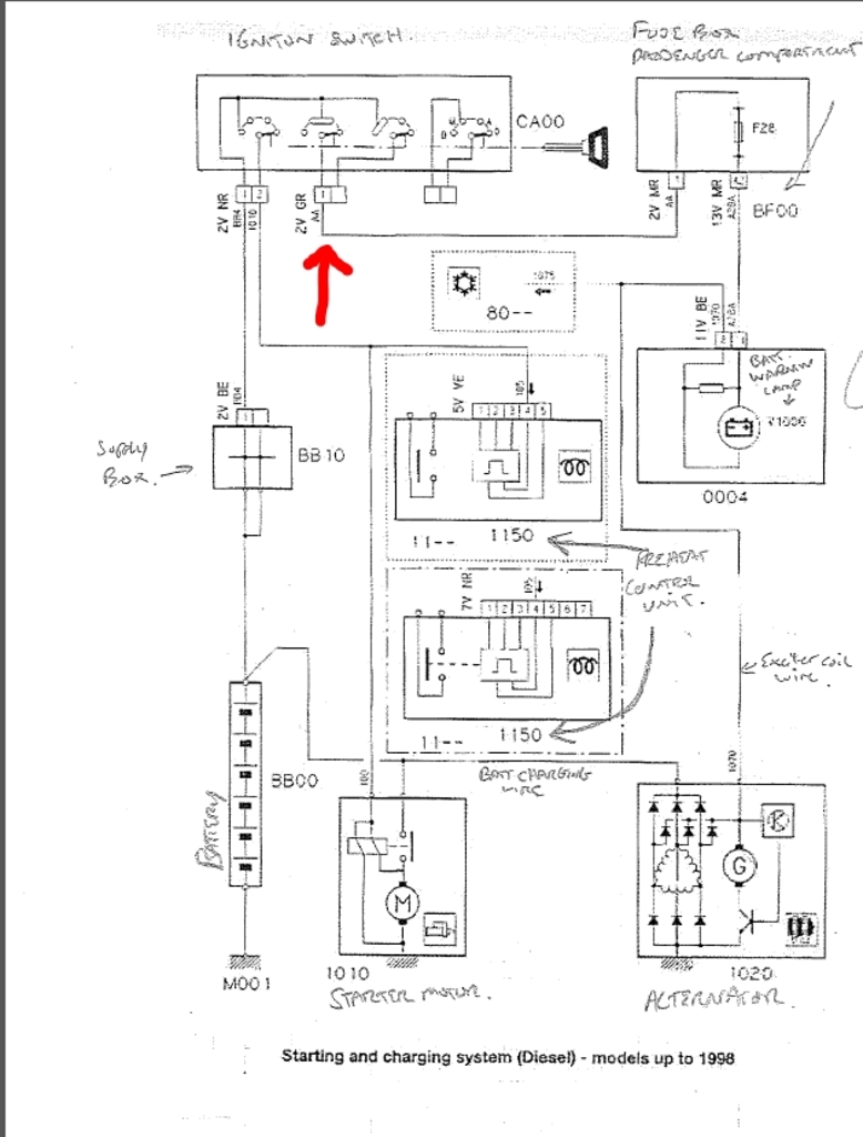

ah, looking at it, there are no relays! (apart from in the glow plug pre-heating units)...
It must be that connection in the ignition switch that directly, (via the fuse and warning lamp), feeds the exciter coils in the alternator!
Boom... cool.
Just gotta find an ignition switch from somewhere, any ideas? :/
Cheers, Romie

That's a strange symbol for a lamp, anyway that's what it must be. If the lamp is on it should mean that there is current flowing to the alternator exciter terminal unless the + end is being earthed but as there is nothing else connected to that output I don't see how.
If you check for 12v on the fuse with the ignition on also check the small terminal on the alternator. When its charging there should be 12v on the terminal and 12v from the switch, that's why the light goes out. If you check for 12v on the fuse that should tell you if the ignition switch is working.

cheers peter, any idea what that thing is that looks like a snowflake, the thing with the 80--? or the other number in the box looks like ?075? :/
ta
ta

I would guess that its something to do with the aircon or whatever stops the blower working when the engine isn't running but its obviously not intended to load the supply.romie wrote:cheers peter, any idea what that thing is that looks like a snowflake, the thing with the 80--? or the other number in the box looks like ?075? :/
ta
