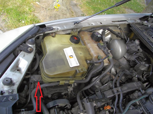

Hi Guys, Looking for a bit of info if you can spare a few mins
What is the connection i have pointed to and what does it connect to? Could unplugging this connection while the engine was running cause a that maxi fuse to blow resulting in a lowered suspension?
I'm in dispute with a garage who was changing a light bulb(tank side) who ended up somehow blowing the maxi fuse and not being able to fix, i then had to take it to a different garage.
- x 6955
Re: C5 suspension won't move
That connection is for the BHI (Electrohydraulic pump and ECU) for the suspension. It provides both the electrical power for the pump, but also the ECU which talks to the BSI and the other systems.
It is never a good idea to unplug the ECU when the car is running - this could brick the ECU as it it could leave it undefined state. On these cars, they have complex computer networks that should be allowed to go to 'sleep' before disconnecting them. That usually entails closing the car doors and tailgate, leaving the bonnet up, waiting 5 minutes or so, then disconnecting the battery negative. That will allow the ECUs and the network to power down and sleep before undertaking any work. I say disconnect the battery negative, as the suspension motor still operates after the engine is switched off.
If the ECU / motor has been disconnected from the power whilst running (bearing in mind what I said above) it can easily cause a problem - as will connecting it back up if the car is running.

Gazzaman22
- Posts: 77
- Joined: 05 Jan 2017, 15:18
- x 2
Thanks Marc, I had to get it diagnosed at a second garage as the first guy got annoyed at me for telling him that he caused the problem, Car was fine going in, and blown fuse coming out. He maintained that it was a new issue that presented. I seen him as he was trying to make space and that side of the car undo nuts of the tank and remove cables, i'm convinced he pulled the plug on that unit, to make space to get his hand in there to get bulb out.

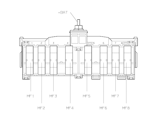

Relevant Maxi Fuses on a 2005 C5 MK II:
MF7 70A power steering electropump unit (Engines EW10A (RFJ) - DW10BTED4 (RHR))
MF8 40A central electronic block motor
Maxi Fuses:
Maxi Fuses:
