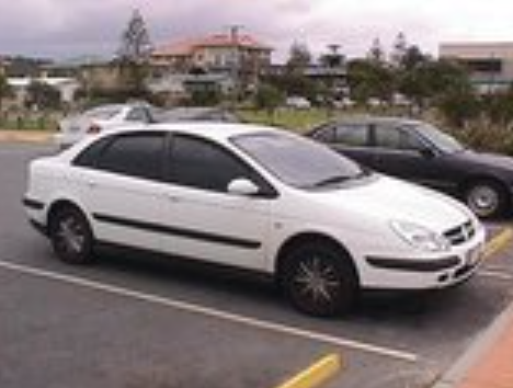

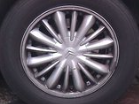

Colgzz What rim is in the picture? I can't find it anywhere.
Clogzz
- Posts: 2125
- Joined: 15 May 2005, 18:04
- x 40
Re: C5 MK1 Tyre sizes
It's a 15 x 6 inch Ronal alloy wheel made in Germany.
I'm in Australia and bought the car second-hand in 2009.
The importer says that it's never had or seen a wheel like that and wasn't an original fitment.
I don't find any photos of it on the internet either.
So, sorry for being of no use.
