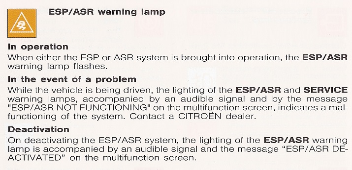

Here is a picture of something close, this is how the warning light looks like
it is Citroen c5, 2004, MK1
Ford Prefect
Posts: 21
Joined: 10 Feb 2012, 08:06
Re: Citroen c5 Warning light - looks like soft-verges
Unread post by Ford Prefect »
Not like this?

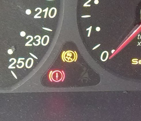

Or this

Ford Prefect wrote:Not like this?
Exactly, that is the one

Nope - not the pressure sensor failure.
The pix is from my car (2003 C5 Break SX 2.0 Petrol) and I dont't have any pressure monitoring system - will have a look in the manual after work.
