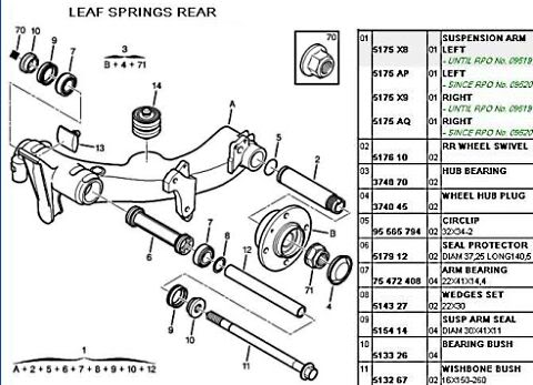

There are no drop links at rear. I think it might be the same old problem of rear suspension arm bearings failure, as in Xantia.superloopy wrote:Drop links at rear? I'm no C5 expert ... do they have them?

Rear arm bearing failiurs are known by a "Cracking" noise when bouncing the rear, also sometimes a knock over bumps.
Ive just done one, the actual arm rebuild was not that bad, but the REAL head ache was removing the R clip from the arm..
they WILL have a job, I sugest you start NOW soaking the rear R clip with Plus Gas... I didn't and I had to split the strut push rod from the Cup, and after removing the arm still couldn't get the cup out, so used an XM rear strut push rod to rebuild the car back up..
The other massive headache was trying to locate the ABS connector plug, which is over above the fuel tank. As the replacment arm had a sensor in it, I had to resort to cutting the cable and joining the other sensor to the wiring on the car..

If the symptoms are as citroenxm described then it's caused by those bearings (# 7) seen in pic.
Notice that there are two of them and there is a repair kit for that.

I went to the dealer for the Plastic protector, the two bush's and two seals... for 28 quid.
The bearings I got from GSF also for about 25 quid..
