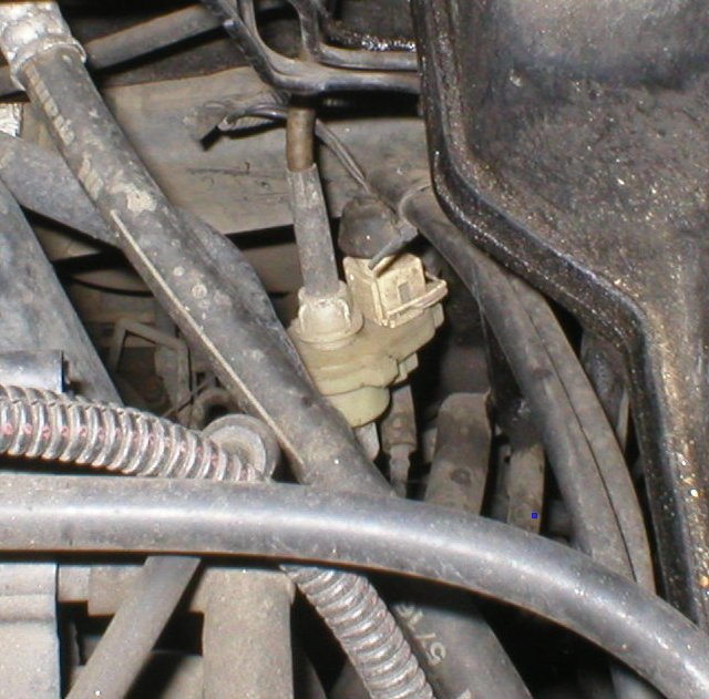

Depends on the XM. An S1 or S1.5 with a cable driven speedo has the speed sensor located half-way up the speedo cable by the bulkhead...
Here's a picture to show where it is..
S2 XMs with an electronic speedo are where Mandrake says... Same as the Xantia...

I have connected the car to lexia and saw that the hydractive control unit can't read the speed. it always shows zero. all other sensors are working just fine. there is no butcheryCitroJim wrote:Depends on the XM. An S1 or S1.5 with a cable driven speedo has the speed sensor located half-way up the speedo cable by the bulkhead...

I failed to locate the speed sensor.
Where I should exactly look at?
