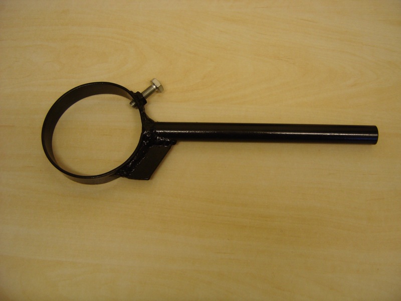

Skull wrote:Priced up spheres whilst I was at the dealers £160 each [-X and awaiting a labour quote for the 3 rears to be fitted (just out of interest as we're on a budget remember)
I hope you told them where they could put their £160 spheres. :shock: :lol:
About £20 each from AEP direct.
Back to the topic and I will now be sourcing the spheres and any necessary tools - initial thoughts are to swap all the rears and clean up the pipes and repaint to try to protect them from corrosion .....
For sphere removal you want something like this:
Oil filter strap wrenches, chain wrenches etc usually aren't up to the task.

Re: 2.1 TD Xantia on a budget
Unread post by Skull »
Mandrake
many thanks for the 'tool' photo ..... I will be scouring my garage for something similar
If only I can find something to fit onto my torque wrench .....

I've got a tool exactly like the one Simon posted a pic of in my garage (I might even give it back to him one day :wink: :lol: ). It shifted the rear spheres on my Xantia no problem, even though they have not been touched for (at least) 100k / 6 years, and 6 Scottish winters. Unfortunately it also removed a large chunk of the OS cylinder, which opened up another whole world of pain, so proceed with caution!!
Re the turning, you are doing on high suspension with the wheels on the ground? The collar on the cylinder will come up against the subframe housing eventually, but the housing is not that substantial....
