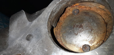

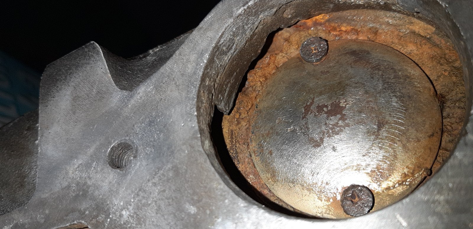

Dear experts,
I am new member here and I am having heating issue also for my newly rebuild engine.
Me and my mechanic has already nailed down the root cause - a corroded breech plug behind water pump.
I already purchased new plug from serie04 in which according to drawing should be the correct one.
However when seeing the actual head, seems that there's another layer of "ring" that is corroded.
And the plug is screwed on top of it.
The corrosion is actually creates water passage between front and back of the plug. That hole is not clearly seen from this photo.
What could be that part?

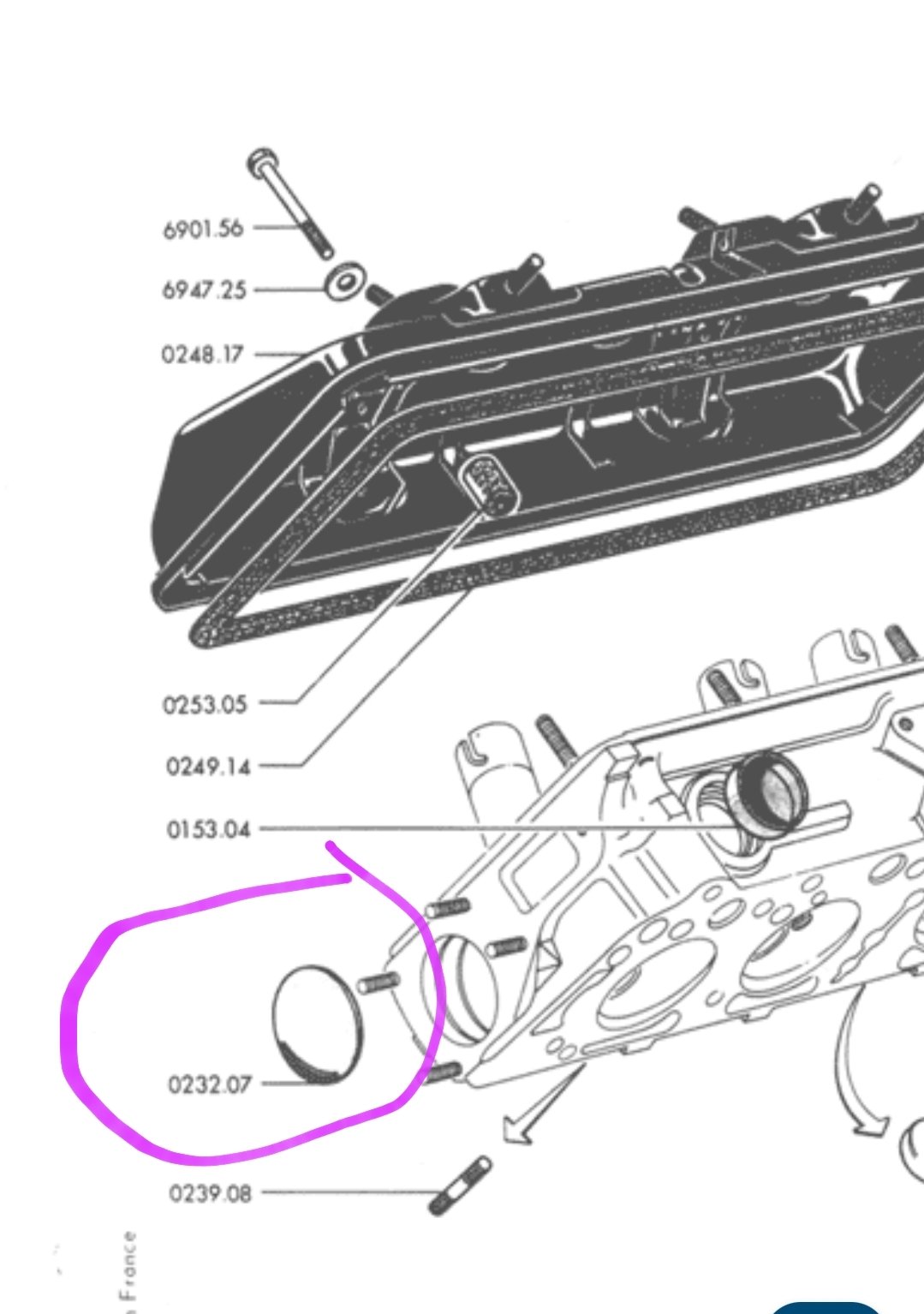

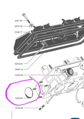

Drawing to clarify location of plug mentioned in my previous post:

That is not pretty... Someone has had a couple of attempts at repairing it badly. Is the new plug the same diameter as the outer ring visible in the photo?
To make a proper repair, you probably need to remove the head and get the hole machined back to a clean round surface.

The new plug has smaller diameter than the "ring"...
At this monent head is already removed from the main block.

That’s the dreaded core plug I mentioned in my previous post.
By the look of that photo it’s been well and truly “got at”, possibly ruined the head? All I can suggest is for you to find an “old school” metal expert, who with the help of some ally welding, could make the new core plug fit properly.
Failing that it’s a replacement cylinder head I’m afraid.

Serie04 have a NEW cylinder head in stock at 495 Euros!!! Dean Hunter at www.peugeotparts.co.uk will have a second hand cylinder head, BUT! by the time its shipped to Singapore it will still be very expensive.

Thank you all for replies! I will try local machine shop first to see what they can do, otherwise I will source a new or secondhand head.
