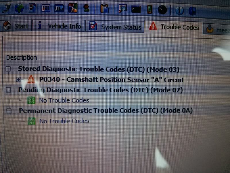

The OBDII came back as CamShaft position sensor fault.

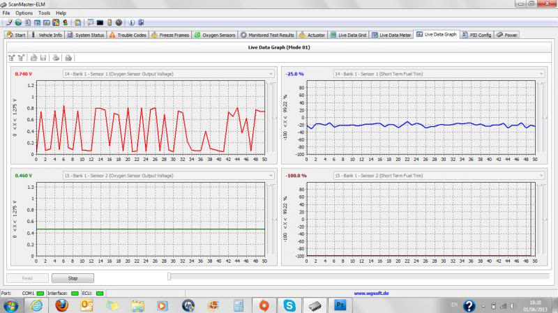

Also I seen the one of the Oxygen Sensors were all over the place with values from 0.2V to 1V ... is this affected by the CrankShaft Sensor?

I have that Camshaft Error code on the OBDII reader...

It's a gem of an engine when it works nicely. Camshaft sensors are a common failure, as is the coolant temperature sensor which could explain the cooling fan behaviour. I've had to replace both on my Mégane with the same engine.

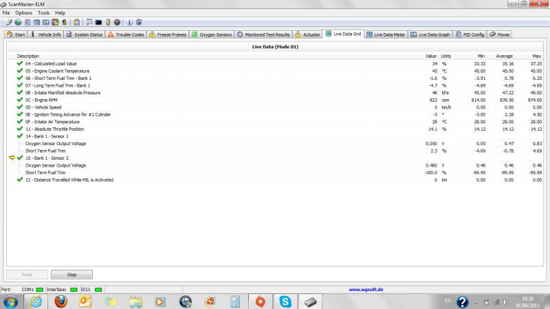

I cannot find the front O2 Lambda Sensor ... at all :( but according to the readings it does exist...
I read online if the O2 sensor give minimum below 0.200V and Maximum above 0.800V then it is a good one.
So the front is doing exactly what is expected...
The rear one ... mmm seems dead??? reads all the time 0.460V if you see in my graphs above. So that suggests this is dead and I need to replace it? Or does the rear (after the cat) doen't come in life after certain time?

The upstream Lambda sensor is at the back of the engine, but accessed from under the bonnet, this is nigh on impossible to access.If all is working correctly, then the second lambda will do very little, as it should be reading clean air.
I suspect your cam sensor is broken, as this is common. OBD readers are not great on Renaults though, there are often other codes present that you will not see.

Well apparently that engine does not have a camshaft sensor ... so this error message can e anywhere on the ignition system :( ...
The Lambda;s are working ok .... so.
